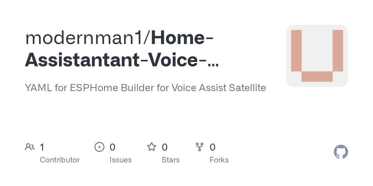

I wasn't familiar with ESP32-C61 and saw an Espressif dev kit on Amazon with 8MB|2MB Prasm and have it up and running. (ESP32-C61-DevKitC-1-N8R2 Dev Board)
I uploaded the yaml and more details on github at
