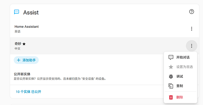

My Home Assistant voice assistant is set to Chinese, but it shows ‘device not found’; when set to English, it can recognize and control devices normally. Has anyone encountered a similar issue, and how can this problem be solved? Thank you.

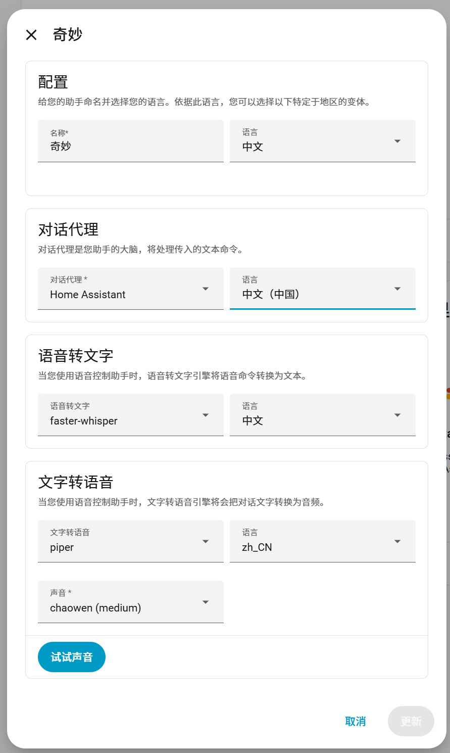

Can you provide a snapshot/image of the configuring for your voice assistant for Chinese?
I’m not using STT or TTS for now; I’m just typing Chinese commands in the chat box. But when the language is set to Chinese, it shows that the device can’t be found, while in English it works fine.

I have HA set up to use my native language as English, but I have a voice assist instance setup for Chinese the same as you and I can type a 中文 intent (example: 打开 Computer Room 的灯) into the dialog box and it works.
When does it show this error… is it when you update the setting or is it when you use a 中文 intent?
