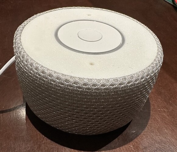

The Voice Assistant PE is a wonderful device but is so lacking in the sound quality area. Amazon Echo Dot's however have a well designed speaker chamber and have reasonably good sound. In the quest to de-cloud the home, we have merged the PE hardware and software with the Echo speaker technology and now have the best of both worlds. Here it is:
All the functionality of the Voice Assistant PE with some reasonably good sound as well.
If you want to see how to do it and download the 3D print files, head over to [Voice Assistant EE]
(GitHub - glbailey/Voice-Assistant-EE: Voice Assistant PE and Amazon Echo Merged · GitHub) and see the wiki.

Ok, just checked that out.
I haven't printed a new housing so far,
just disassembled the original circuit boards and connected the VPE to it.
Sound is loud and clear, a more than welcome upgrade over the default speaker when you use it in a larger living room (I'm not using the VPE for music, but the default speaker is also way to weak for voice if your room isn't that small).
