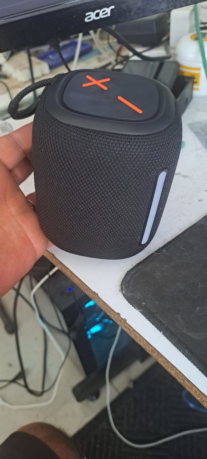

I like to share my code for a voice assistant, it’s been hard to actually make it work, I modify a Bluetooth speaker and add it inside for more appeal case.

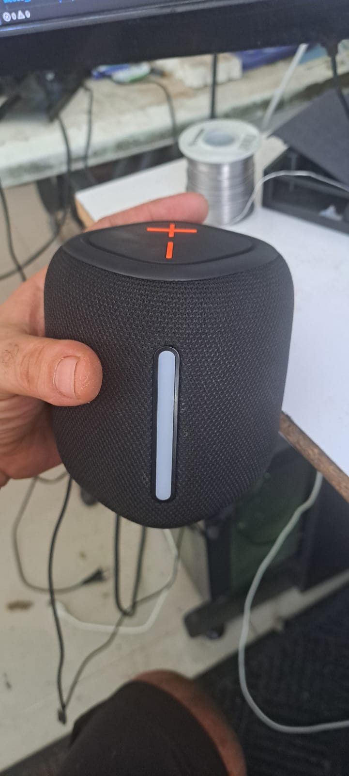

Looks great. What’s the speaker you’re using?
is a chinesse one only cost 5 dollars in mercadolibre is a pgae like ebay i been trying to find it on aliexpress with not luck

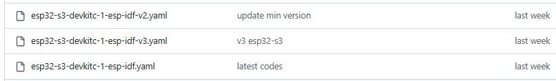

I upload to GitHub a few codes for different boards, im still working on them,

Can you describe more about these 3 versions. Thanks a lot!
