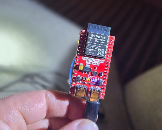

Post a photo of your board with the esp chip visable. Not a link to where you bought it. Show the connections as well . Then we can tell what you have.

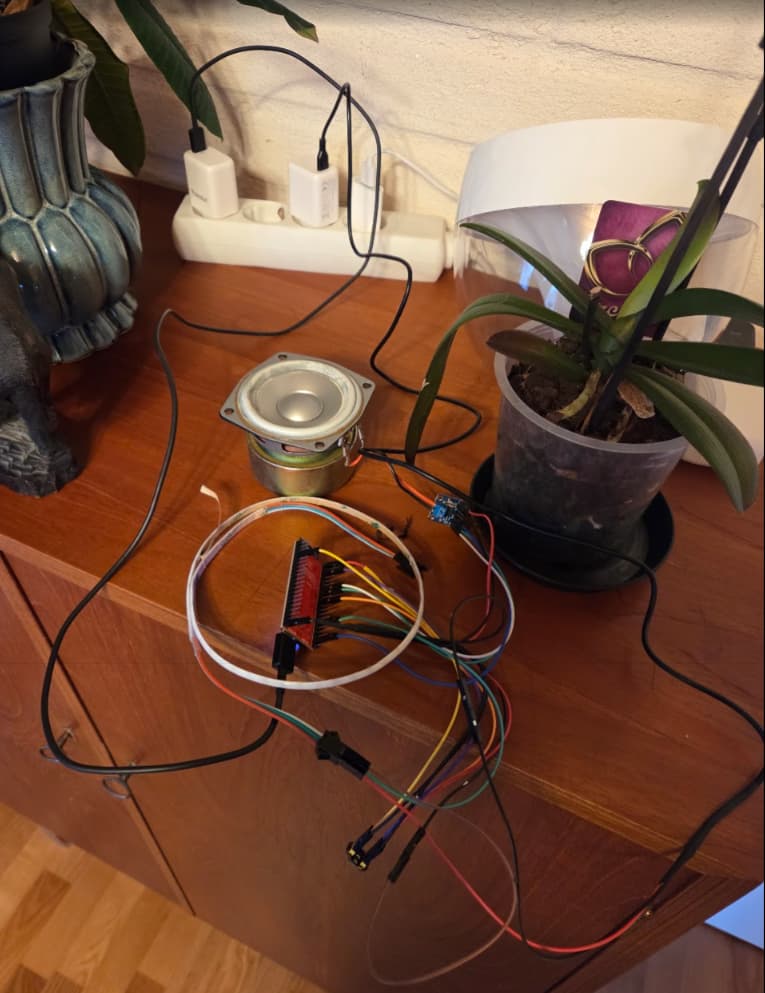

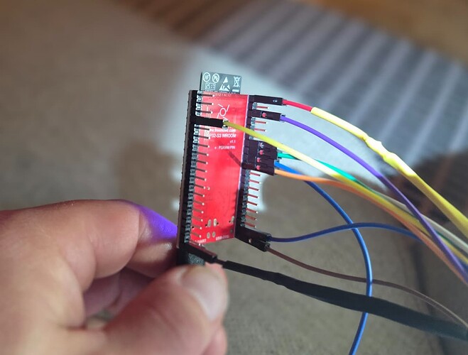

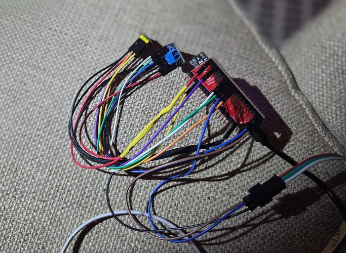

Here’s couple of photos:
Led is not responding. Led’s white is connected to GRD, red to 5V on board, and green to pin nr 17. But hmm…what does this actually mean:

I just looked at your pictures and noticed that your board does not have a solderpad for the 5v pin. So probaly it is already connected directly and you can use it also to power the board with 5V

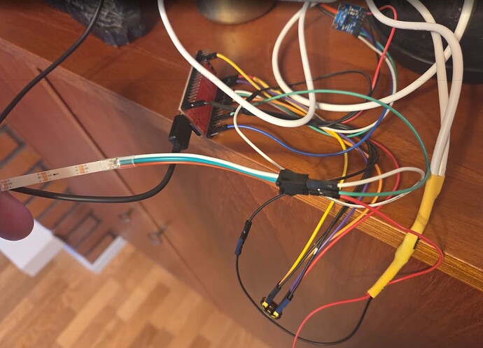

Right now, I have a complete LED strip connected to the ESP with 30 LEDs. The YAML is currently set to use only 5.
Wiring details:
White wire is ground, connected to the ESP’s ground, the power adapter’s ground, and other component grounds (mic and amplifier). Both the mic and speaker work fine.
Green wire is data, connected to GPIO10 on the ESP.
Red wire is +5V, powered from the power adapter.
If you check my photo and wonder about the two white USB cables and the yellow heat shrink tube → I have two 5V 3A power adapters, each with a red wire if needed. I’m currently using only one of these adapters, which powers the external LED strip. Grounds from both adapters are connected together, and they are also connected to the other grounds.

EDIT: To avoid any misunderstandings about the power adapter, I went to make a new power cable where ground and + are simply connected without any strange variables. Attached is a picture of the wiring jungle, but the end result is the same → the LED strip does not work.
For me the ledstrip looks strange
Is this a WS2812 chipset ledstrip?
How to debug?
Start simple. Make a yaml that only control the ledstrip
For now save your voice device yaml and strip everything from it except the light
If this compiles without error but isn’t working then your ledstrip might have a different chipset
Here you can find the available chipsets for the RMT platform
https://esphome.io/components/light/esp32_rmt_led_strip/

Thanks. Led strip test was successfull. I installed new ESP board and tested it there. Next I’m going to copy the full YAML to the new board.
EDIT: The second ESP worked perfectly right away with the previous YAML code and straight from GPIO10 pin. I copied the code to the problematic ESP and after installation this ESP also started working as it should. So it’s a completely mysterious thing. Could the first installation have been broken somehow even though nothing was actually found. I think I’m not going to power the led strip with a power adapter at all. It seems to work just fine when powered from ESP 5v pin.
Thank you for your help and now I can start testing properly.
