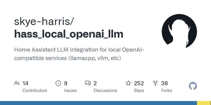

I wanted to return to this and say thank you. I wanted to experiment further before adding yet another variable, but this (notably the very last feature in the doc) appears to be exactly what I need if I want to override the OIlama’s prompt addendum. I haven’t done so yet, but put it in vanilla and saw that things still worked.
But yes, this seems to be the real answer to my original question. (Begs the question if I really NEED to modify it, or if it’s something else, but now I CAN modify it).

Extended OAI solved a problem with things the builtin OAI could not solve in the beginning. Specifically, the ability to change the endpoint. It has its own tool calling surface that hasn’t aged well. Once the real oai started doing tool calling I dropped extended - too much trouble.
I use local LLM for connecting to my local server. And am considering ^^^ for my zenos builds in the future.
Things I want to personally change
The default prompt should never call out tools to use just basic grounding. Some of the integrations don’t do it the same way. This leads to tool call conflicts when you have something different and in conflict than the integration system prompt. Thier words win.
If i want to override /takeover the builtin intents for things like HassTurnOn and add an RBAC envelope I can’t do it with most LLM . That one does.
The combo would allow me to replace HassTurnOn (disable all the tools I don’t want and turn off assist first) then provide my own. Without the prompt telling the agent to just look everything up with get live state and turn it on with Hass turn on. (default is setup as a wide net sledgehammer. I want a scalpel)

Is the “real oai” you mentioned the cloud integration, and what is the “local LLM” mentioned, is that yet a different one that replaces Ollama (the integration)?
‘real’ in your question is the core provided one
Skye also… Custom integration for connecting to local LLM providers.
You would use this instead of the core oai provider
You’ve notices lots of puzzle pieces and they’re not all the same shape.
