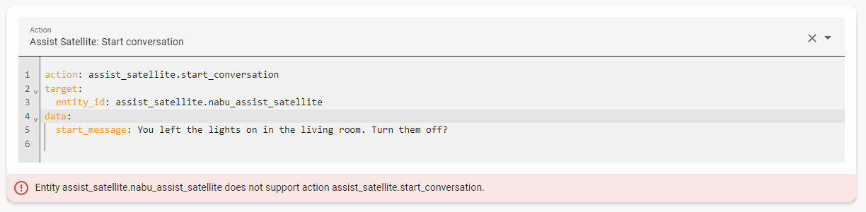

I noticed in the release notes assist_satellite.start_conversation
I have My Voice Assistant PE setup with LLM.
But Cannot select my PE it with assist_satellite.start_conversation
In the release notes i see (Starting a conversation with the default conversation agent is a bit more work and did not make it this release).
Does this mean it still in development for the Voice Assistant PE?
Tried the same - same result…
I assume we need to wait for a firmware update for the PE …
