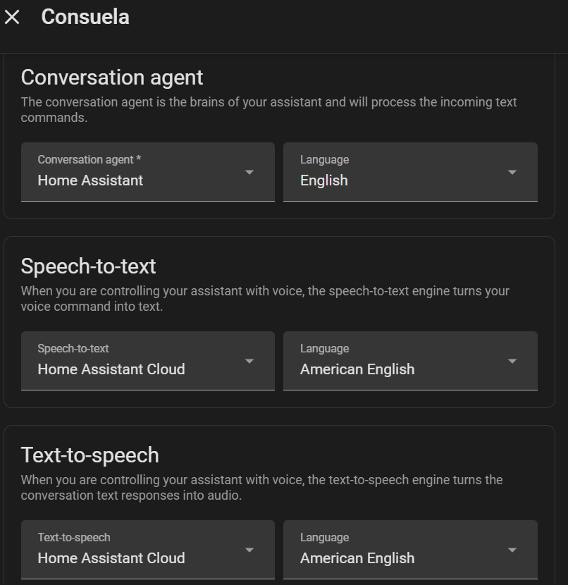

I’ve set up the voice assistant, registered to the HA cloud service which is now live, and added TTS and STT to work with it.

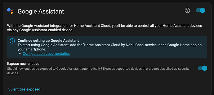

Google connected, all devices (supported) are visible from google home.

So basically, when talking to Assist in voice, it always STT-> “Sexy Baby”, but the device called “Sexybaby” without space, therefore it won’t find it…

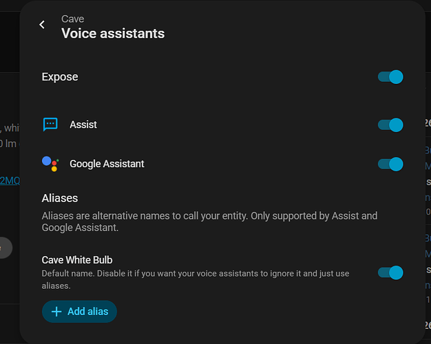

As far as naming, you can create alias’s in the entities settings.
Find your device, click on the entity you want to control (the light on/off switch), click the gear at the top right, look for the voice assistant menu, add alias button at the bottom.
add an alias for ‘sexy baby’ and see if that works
Added the aliases, but it’s even worse now.

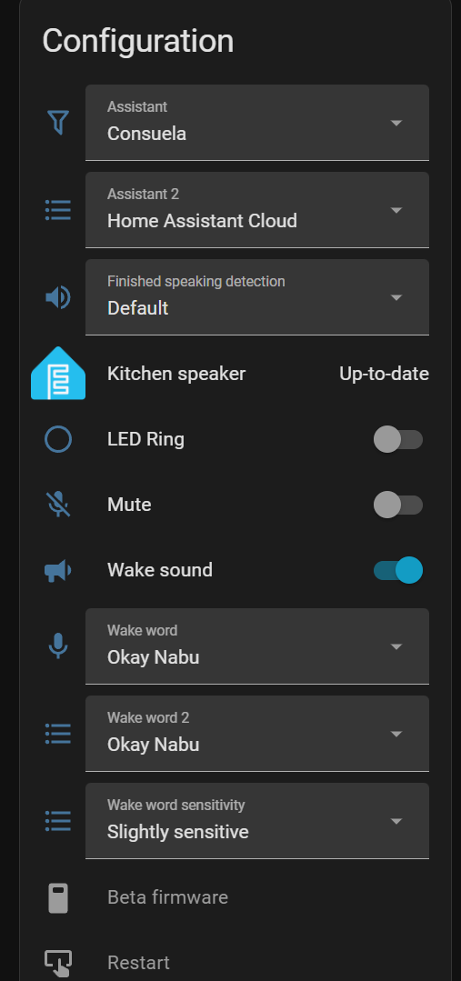

Also, since I set up the Gemini API for the voice assistant, the VPE will not work at all. Sometimes it says can’t get a response, most times it loads white for a couple of seconds, and turn off without saying or beeping anything…

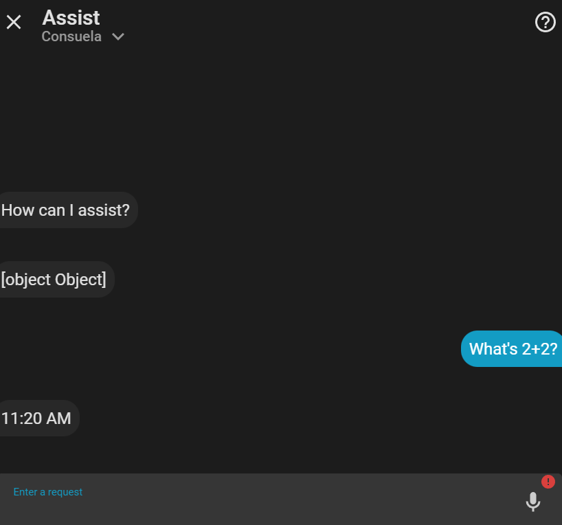

Changed to OpenAI API, and chaching, the VPE also works and answering simple questions like “What’s 2+5?”.
Next up, custom wake word and running conversation instead of always saying OK Nabu. :slight_smile:
