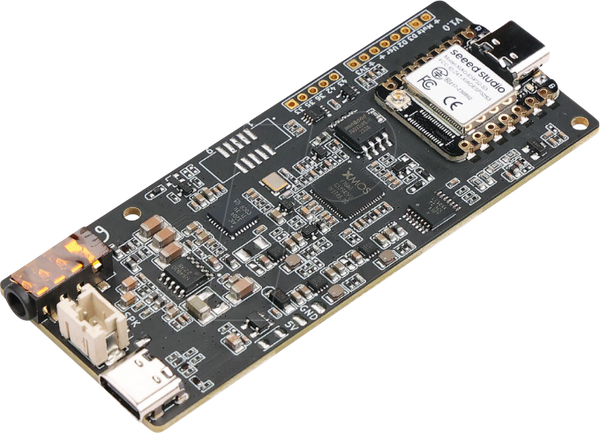

You all know the Respaker Lite or at least you can find everything about it…

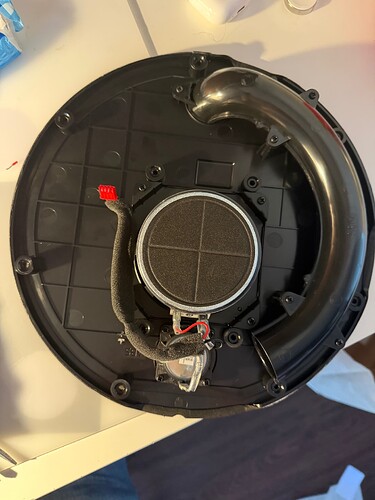

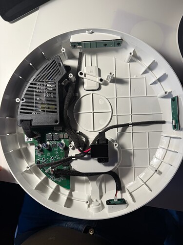

I removed the front panel and opened it.
There is a lot of space to use…

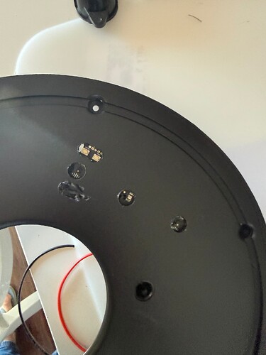

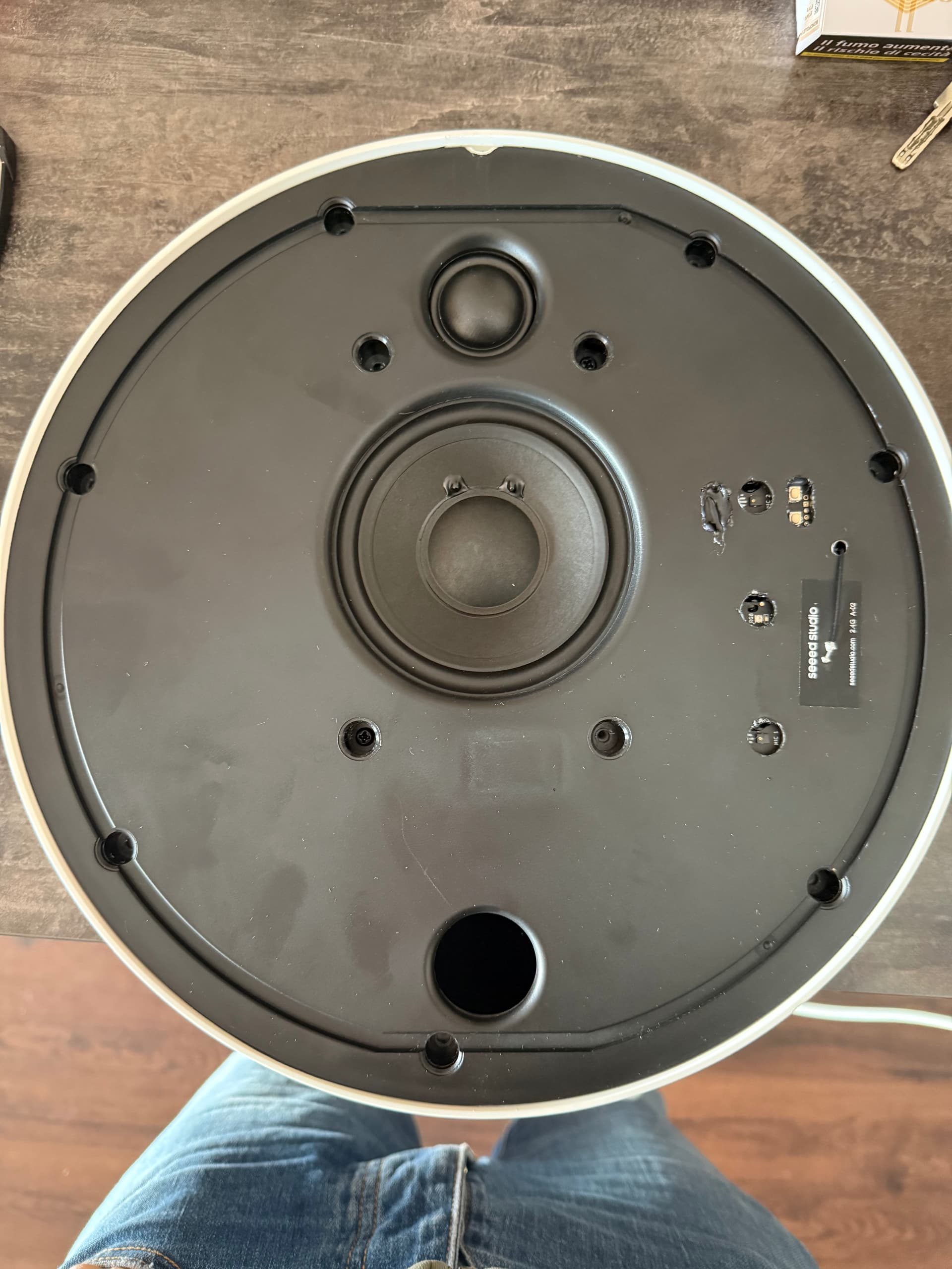

With a drill I made holes in the front for the microphones and the led and and I glued the Respeaker with hot glue

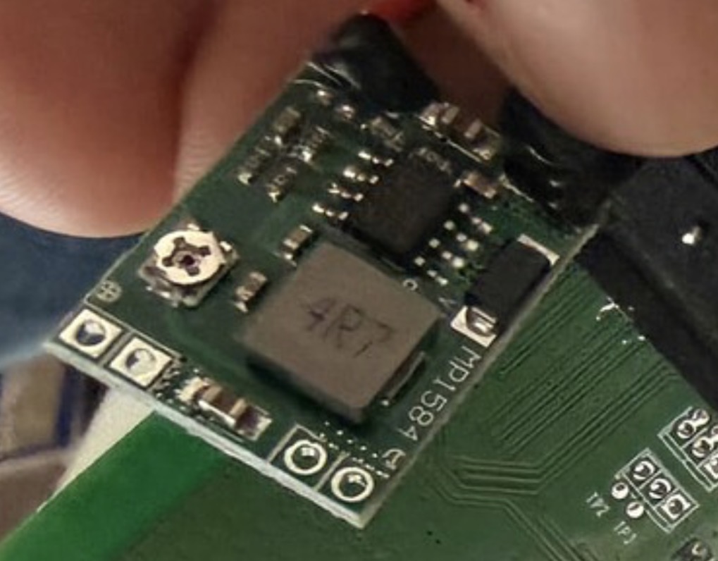

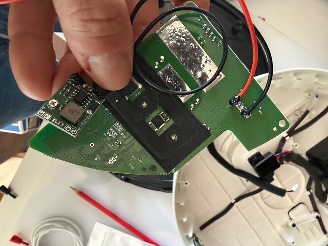

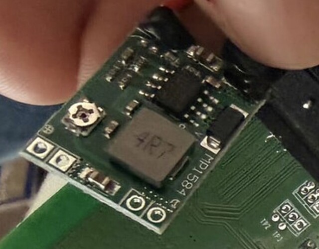

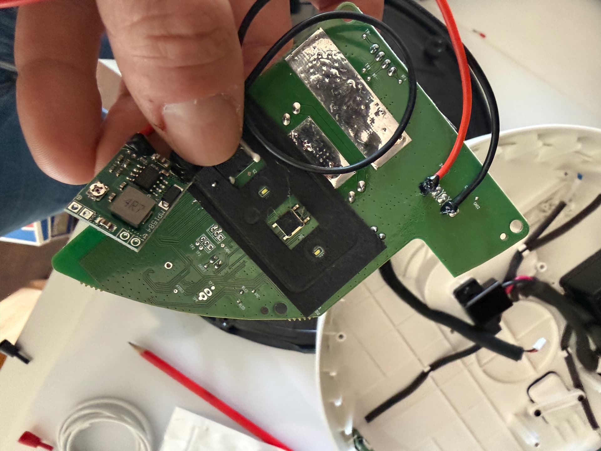

the SOLSKYDD board has two 24V leads so I used a step down converter to bring the 5V to the Respeaker:

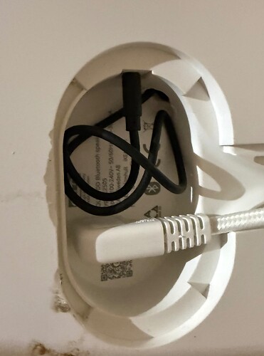

I connected the 3.5mm cable and made a hole in the back so it could reach the SOLSKYDD input.

I love it! Are there any interferance from the ReSpeaker that is audioble from the speaker? Buzzing and such. What step down did you use?

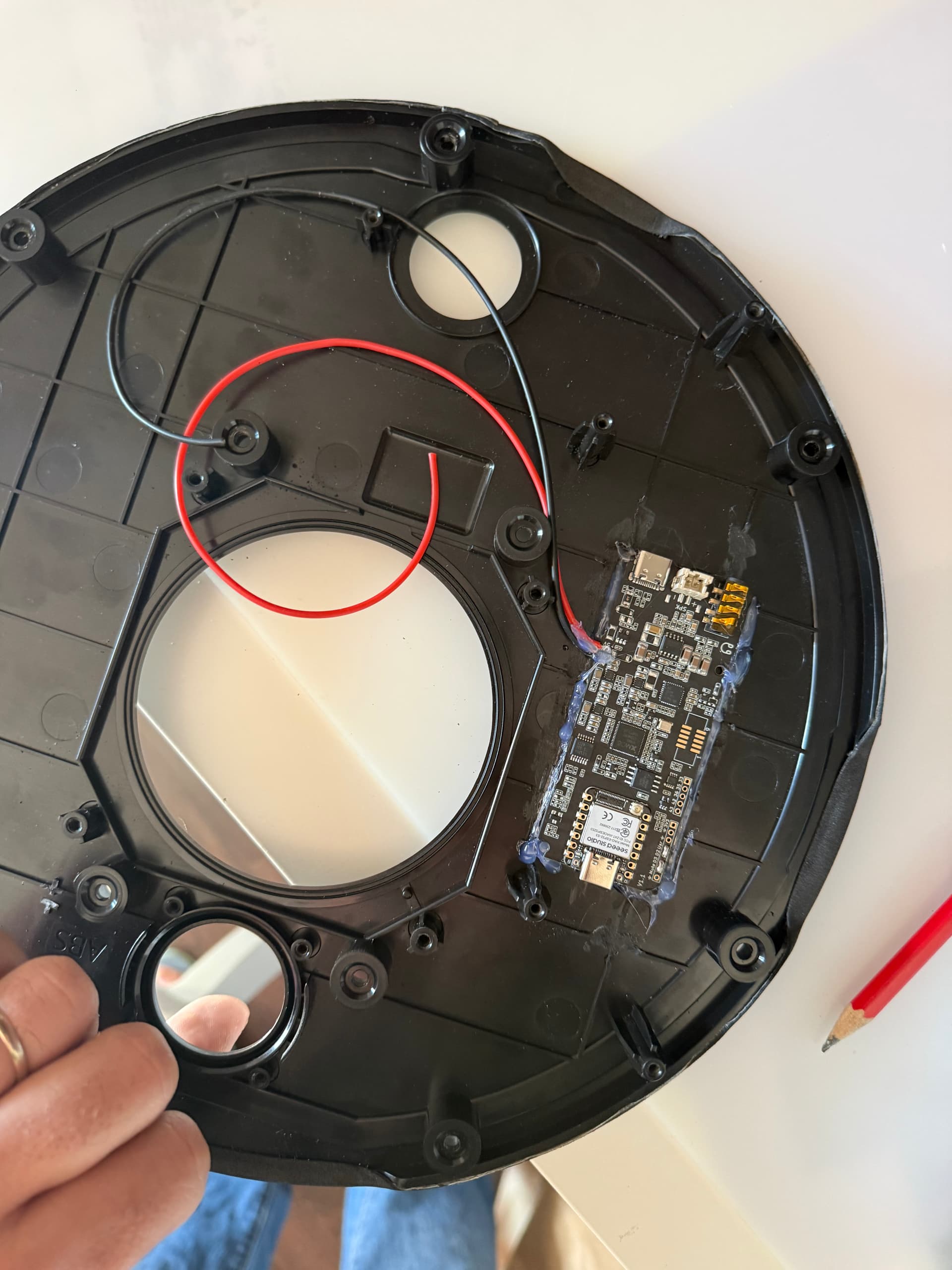

I don’t have any blackout problems at home but this can be fixed… yesterday I added an ESP32C3 with an LD2410 inside. You can clearly see the movement through the plastic.
The Step down is in the photo.
It can handle 4.5 to 28V.
