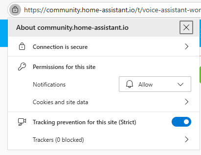

Browse to your HA instance using HTTPS
Click on the lock symbol in the address bar

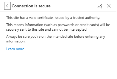

Click on “Connection is secure”

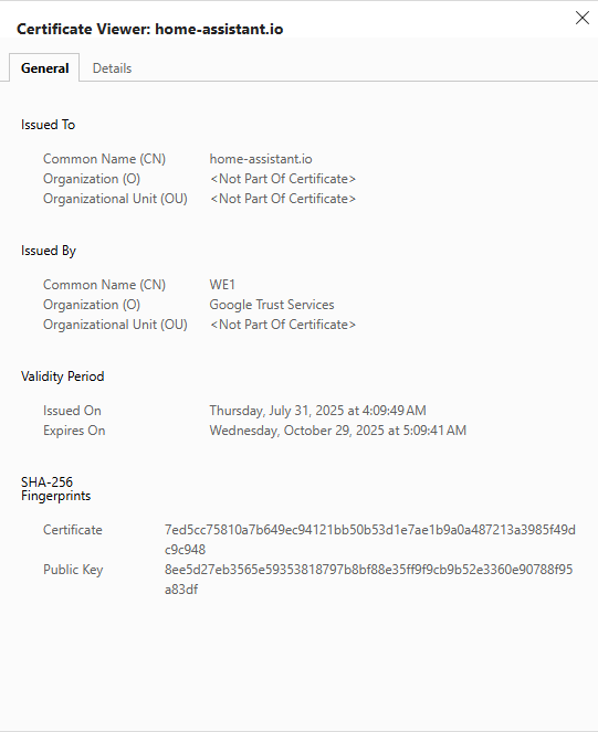

For more details, click on the Icon next to the X
This is assuming you haven’t directly added the certificate to your computers certificate store as trusted, as is often done with a self-signed certificate. The details tab should show it traced to a Publicly trusted Root Certificate authority.
