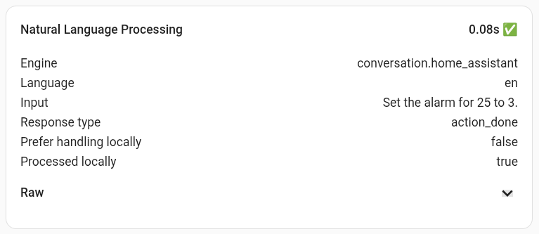

As you say, the only number that Home Assistant provides is the Natural Language Processing figure in Assist debug:.
But this only represents time taken by Assist to process the text provided by speech-to-text and interpret its meaning. It doesn’t include the time taken by STT itself or by any TTS response. It is not available programmatically, so its use as a debug tool is limited.

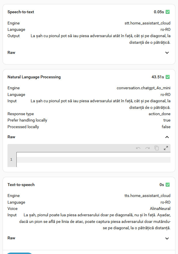

My screenshot fits best to this title …
From time to time I have a VEEERY LOONG response time … usually it’s faster, like … ~2…5 seconds for NLP, but … this was the record:
