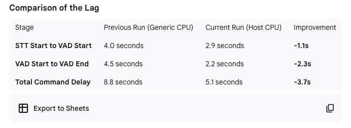

I’ve tried using Home Assistant Cloud for everything, and I’ve also tried using Gemini as the conversation agent.
In troublehsooting with Gemini, we came back with the Proxmox box hadn’t been set to Host for the CPU. So, I did that, and then it came back with a pre and post comparision of the lag.
It appears that the delay is in the Voice Activity Detection (VAD) stage.
I set it to Aggressive to close it out quicker, and it helped… but it’s still much longer than pre 2026.1 (or 2026.1.1)
