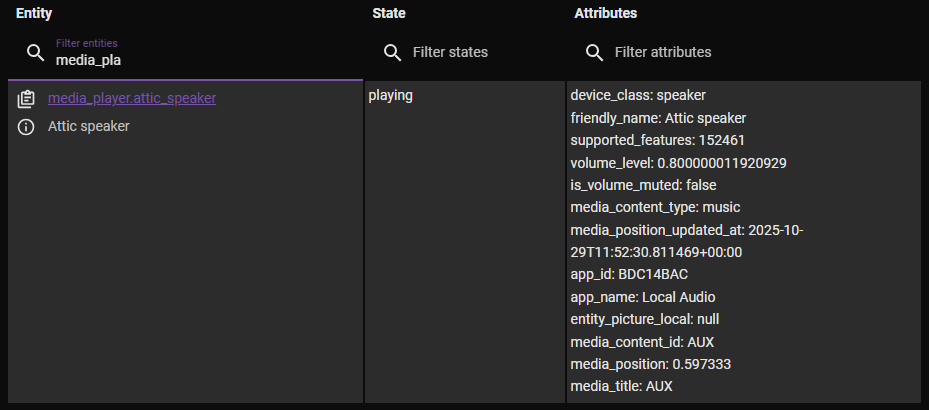

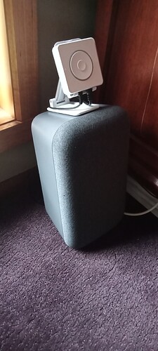

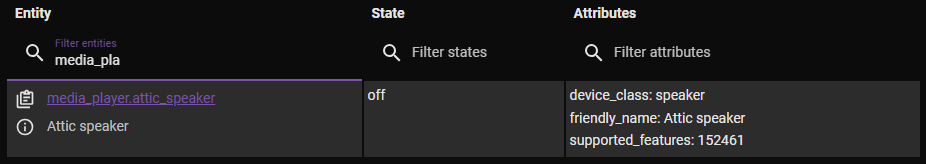

@Linwood. I have just installed a HA Voice PE on each of my three Google Max Speakers.
State in idle
When speaking to the HA Voice PE, the Google Max Speaker automatically switches to AUX (Auxiliary) input and app_name: Local Audio.
  • The speakers can still be used for casting and operate like normal. (While the Auxiliary cable is plugged in)
  • When it detects the Auxiliary is active it just switches to AUX automatically and then back to normal casting mode when no AUX signal is detected (Approx 30secs later).
  • I have been able to get the HA Voice PE to play music through the Google Max but the sync is not very good even if they are grouped. (I am still using my Google Home App Speaker Group on the same set of speakers for Music)
  • While casting music to a group of Google Home Max, there does seem to be a bit of a stumble if activation a Voice PE Auxillary input on one of the speakers.
  • Setting up as a stereo pair did transmit the HA Voice PE from the left (Master Speaker) over to the other speaker, a slight delay is experienced. But a HA Voice PE plugged into the other speaker did not reliably cast back the other way.
  • No cross talk interference between Okay Nabu and Okay Google.
  • Playing music through a Google Cast Speaker Group and trying to talk to a HA Voice PE while this is happening. Confuses the group of speakers when the aux is activated on one speaker and or ignores the aux input. Not the end of the world, just don’t use voice prompts when playing music.
I will report back with further findings, so far you would think the Google Max speakers are purpose designed for just this use case.
