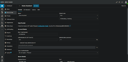

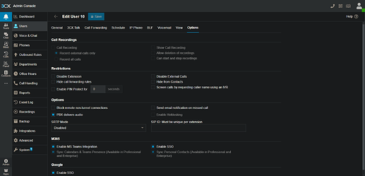

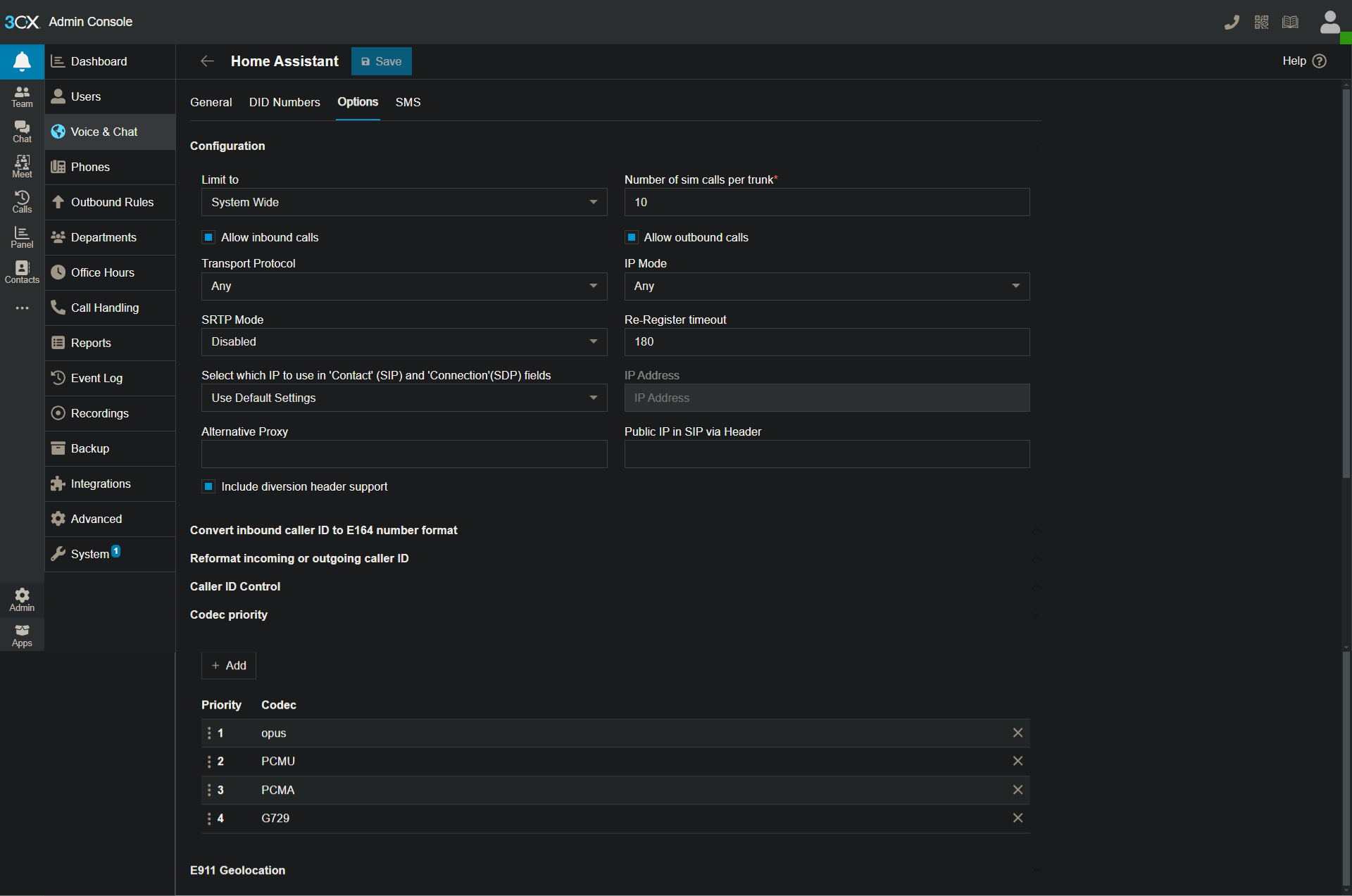

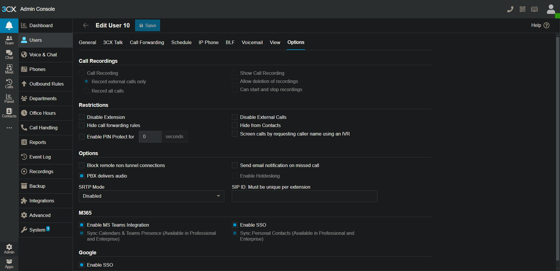

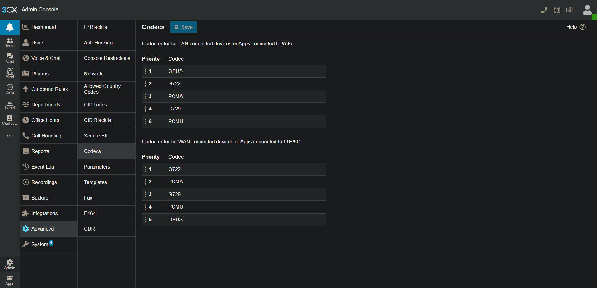

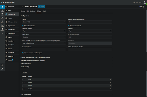

Hmm, posting some pictures of my configuration as well in case someone sees something wrong or missing.
I will try to see what the logs on 3CX side’s show at the same time too

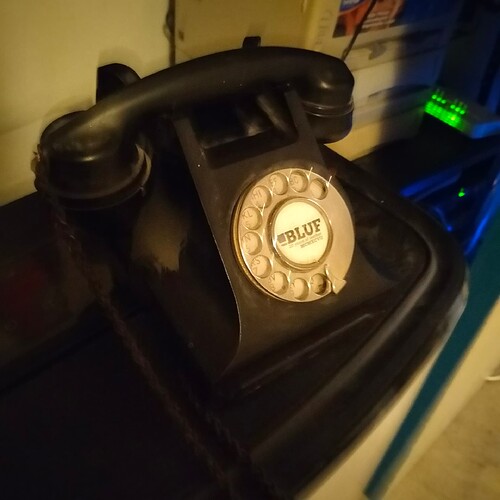

Finally, for my step 4 - not necessary for everyone - I used the analogue port on the UCM6301 to press into service a GPO Type 300 telephone; the UCM doesn’t support pulse dialling, so under Extension/Trunk, Extensions for the relevant port, click the Features tab, enable Hotline, type Immediate Hotline, and set the number to 33 (or whatever else you chose).
Now, I can just have my butler pick up the phone and say “Turn on the hall lights”
