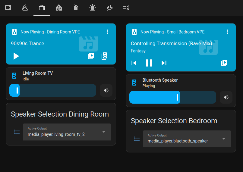

I have a helper selector with my BT speakers (beginning media_player. )
and I have an automation to pass to the chosen BT speaker this works. Automation:

This VPE config works better. It retrieves on booting the current set media_player in the helper selector and works after a power off then power on.
TTS ouputs to the chosen_speaker and the “radio player” automation works too.

Here is a potential solution that works (albeit rough around the edges). Currently I have 2 VPE devices with 2 sets of selectors that lists all speakers that are available in HASSIO Music Assistant add-on/ app as media_player entities:
The following add-on/ app is being used to add Bluetooth speakers as media-player entities:
VPE config (adopt/ take control VPE into espHOME Builder):

Create Text Helper to store selected Speaker entity_id:
Helpers > Create Helper > Text.
  • Give it a name e.g. “Music Assistant Target Holder 2”
  • Go to “more options” change maximum length to “255”
Create the Speaker template Selector helper:
Helpers > Create Helper > Template > Select
  • Give it a name e.g music_assistant_bedroom
Put the following in “state”
{{ states('input_text.music_assistant_target_holder_2') | replace('\"', '') | replace('\'', '') | trim }}
Put the following in “Available options”
{{ states.media_player
|selectattr('attributes.mass_player_type', 'defined')
   | selectattr('state', 'ne', 'unavailable')
   | map(attribute='entity_id') | list }}
Put the following in “Actions on Select” (edit in yaml)
action: input_text.set_value
metadata: {}
  entity_id: input_text.music_assistant_target_holder_2
  value: '{{ option }}'

Dashboard Card. HACS “Mini Media Player”, “Config Template Card” must be installed:
type: grid
square: false
columns: 1
cards:
  - type: custom:config-template-card
    entities:
      - input_text.music_assistant_target_holder_2
    card:
      type: media-control
      entity: ${states['input_text.music_assistant_target_holder_2'].state}
      name: Now Playing - Small Bedroom VPE
    entities:
    card:
      type: tile
      features:
        - type: media-player-volume-slider
  - type: entities
    title: Speaker Selection Bedroom
    show_header_toggle: false
    entities:
      - entity: select.music_assistant_bedroom
