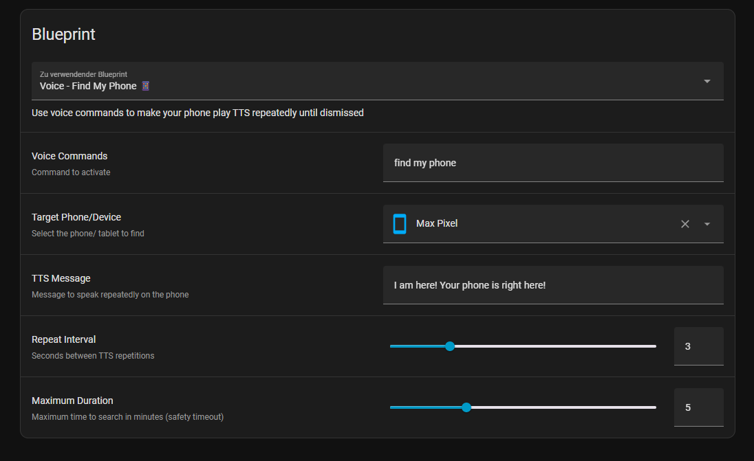

I recently lost my phone (again) for a few hours. In the past, I would simply ask Google Assistant for help, but since I’ve banished it, I had to come up with a different solution :smile:
That’s why I created this blueprint—it should make finding your phone much easier. You just define a command, specify which phone to locate, and set a few details for the TTS (Text-to-Speech).
Here’s the link:
I’ve only tested this on Android so far—hope it helps!
