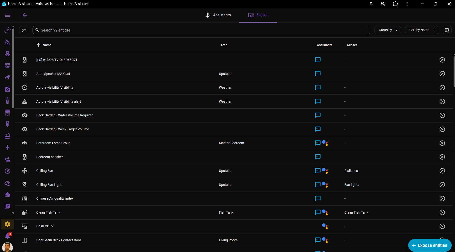

Have you exposed entities to Assist?
Settings >Voice Assistants >Expose (tab at top of page)

I fixed it for you.
