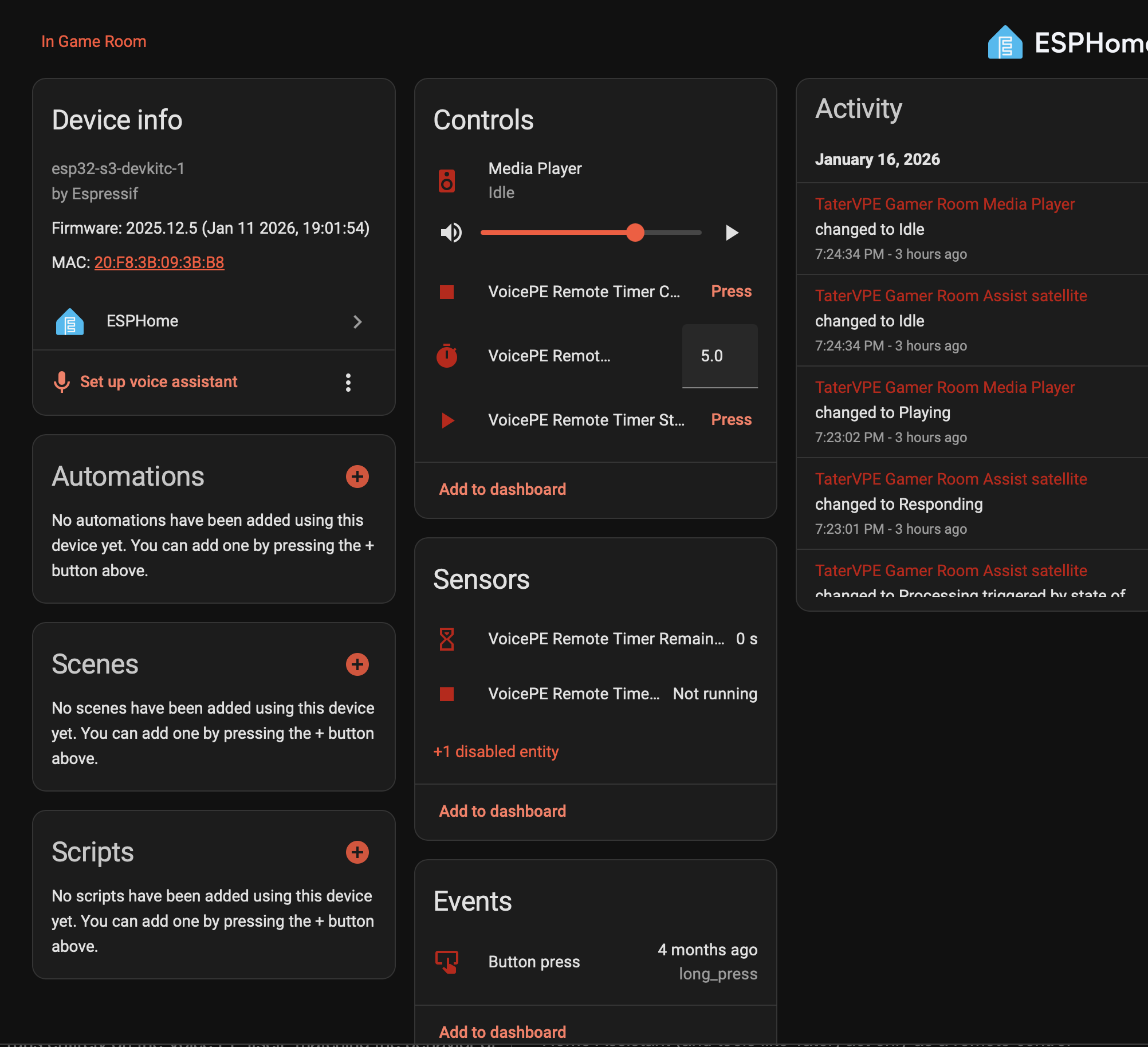

I added something close to what you want, but you will have to get home assistant to trigger the remote timer vs the built in conversation timer
