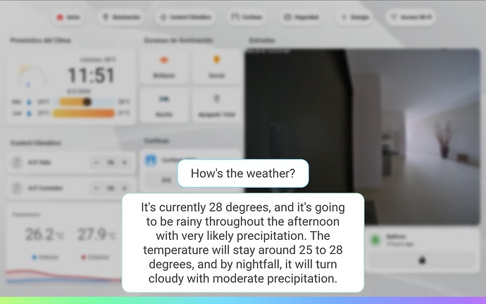

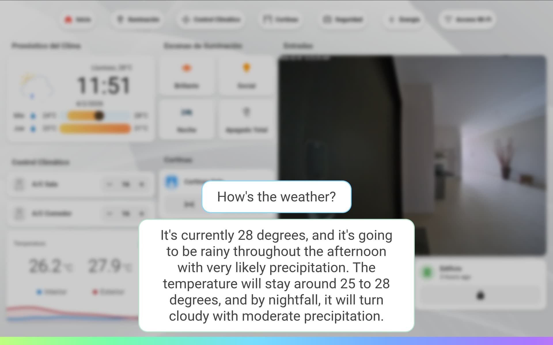

You drop it into any dashboard view and it works invisibly in the background. When it picks up the wake word, it shows a subtle gradient animation bar and transcription bubbles, processes your request through the pipeline, and plays back the TTS response through the device speakers.

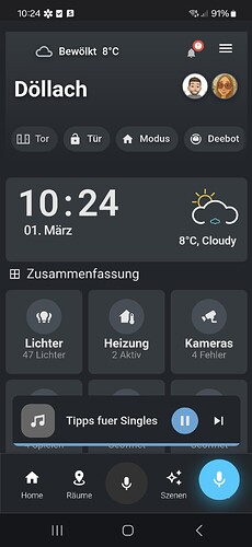

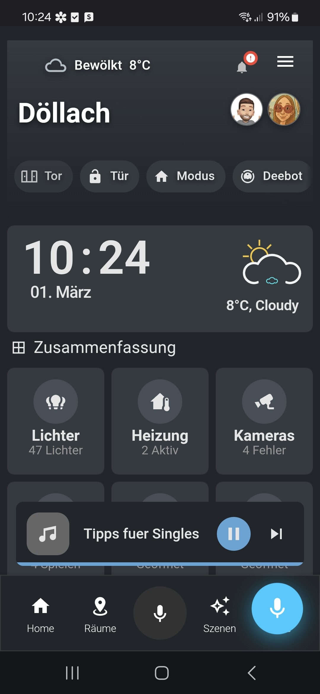

Hi. Many Thanks for this Awesome Projekt. But i have one Question, is there a way to hide or move the the blue microphone button ? Because when you have your Navigation Bar on the Bottom, the Button is over the Menue.
Can you show me a screenshot to see what you mean?
Hi. On Tablett Dashboard it is no Problem with the Bottom bar, but when you have the Navbar on Bootom on Mobile, the Mic is over the Navbar Button. Here the SCreenshot. Thanks for help.
