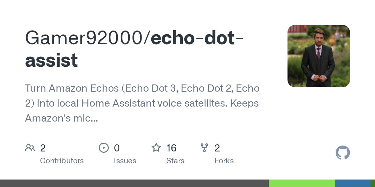

Another solution, that works very good and way superior to the VPE in regards to wake-word detection and beamforming / far-field processing is the rooted Echo Dot 3 with this solution:
Posted some thoughts here after the latest update fixed a problem with the audio / speech recording:

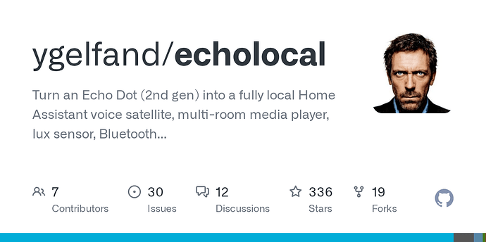

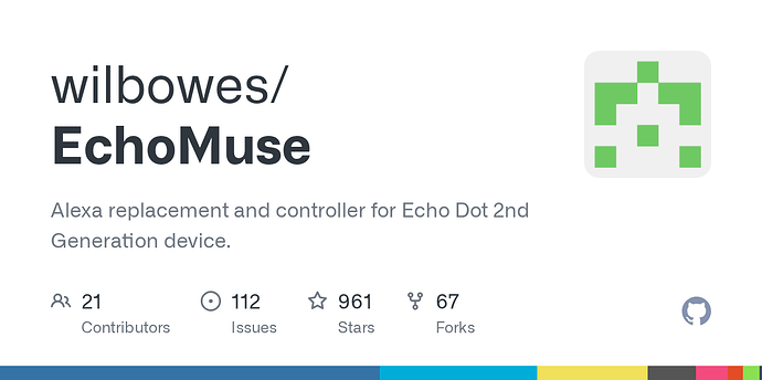

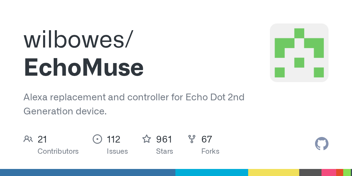

theres also these echo projects

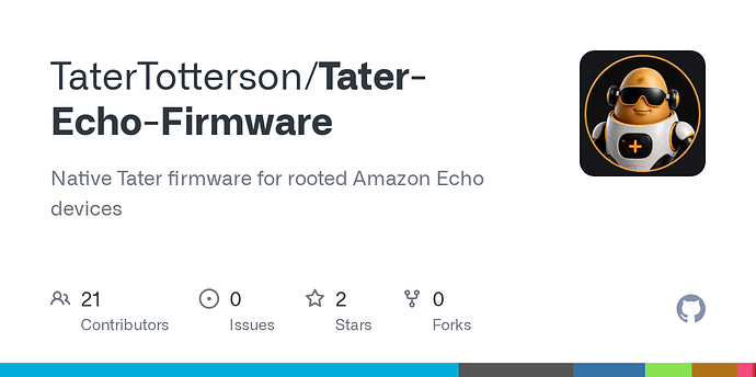

working on doing these Tater style firmware as well
now we can have sats with screens, cameras and 7 mic arrays

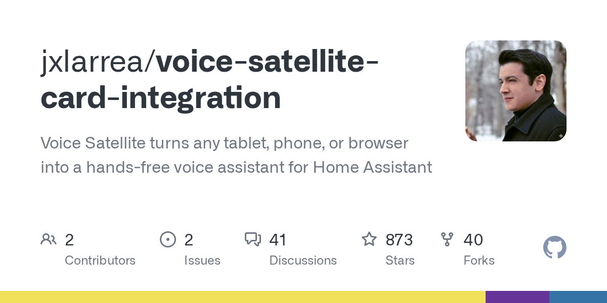

any device connected to ha with mic
