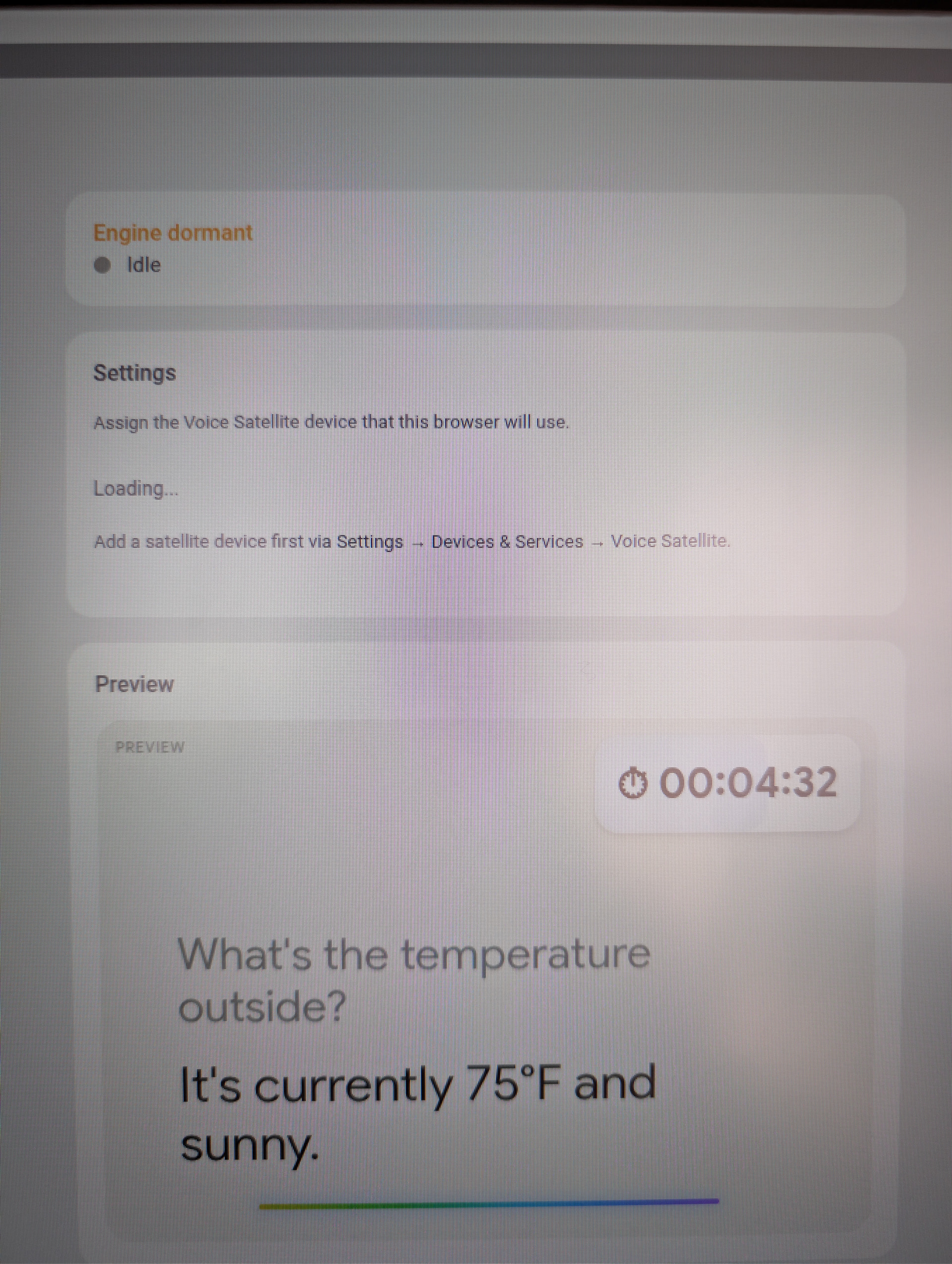

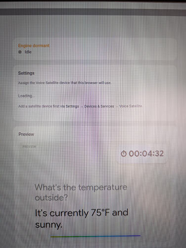

Recently, after updating my raspberry pi devices the voice satellite integration will not load properly on my rPis and am stuck with "Loading..." where the selection for a device should be:
All other devices work as they should. But, if I switch to a HTTP connection on the rPis, I am able to select a device.
Any idea what could fix this? I have already done:
  1. Reboot
  2. Clearing site data/browsing history
  3. Purge and reinstall chromium
  4. Reinstall Rasbian OS
I haven't tested another browser yet and I am unable to run the diagnostics via HTTPS, but can on HTTP. There are not errors/warnings other than not being on HTTPS to use the microphone.
