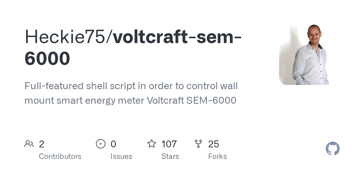

I want to ask you something, I’ve been using this
to poll them via BLE so I can get metrics into Prom/Grafana. It works fine overall but periodically SEM6000 would lock me out refusing any connections until I do a power cycle.
Have you ever experienced anything like that ?
Nice! ^^
I haven’t tried that project yet, but I’ve definitely seen the repository. It’s quite a bold move to write the whole thing as an expect script. I’m tipping my virtual hat to whoever wrote it. I wouldn’t have the nerve for this much expect scripting. :3

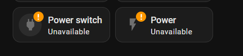

It worked fine for ~6 hours but after HA shows this :
It comes back to me if I reload your integration
When its unavailable, it stops reading from Volcraft, as I have REST api to query data from HA and it just returns same value. Once I reload integration it starts to report different values, so I assume it works.
I dont have anything else connected to Volcraft apart a single instance of HA. I do have Bluetooth proxies but I guess they shouldn’t pro-actively connect.
This is exactly same behavior I had with expect thing. It would work fine until it stops syncing and the only way to fix is to power cycle Volcraft. At least with yours, seems like reloading integration fixes it.

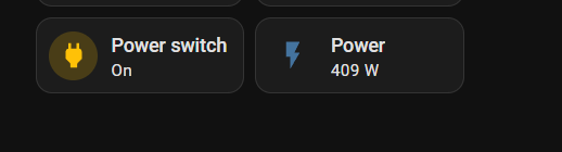

So when I wrote my post yday, I reloaded integration and it worked.
Now it shows this again :
Started to work again after reload.
