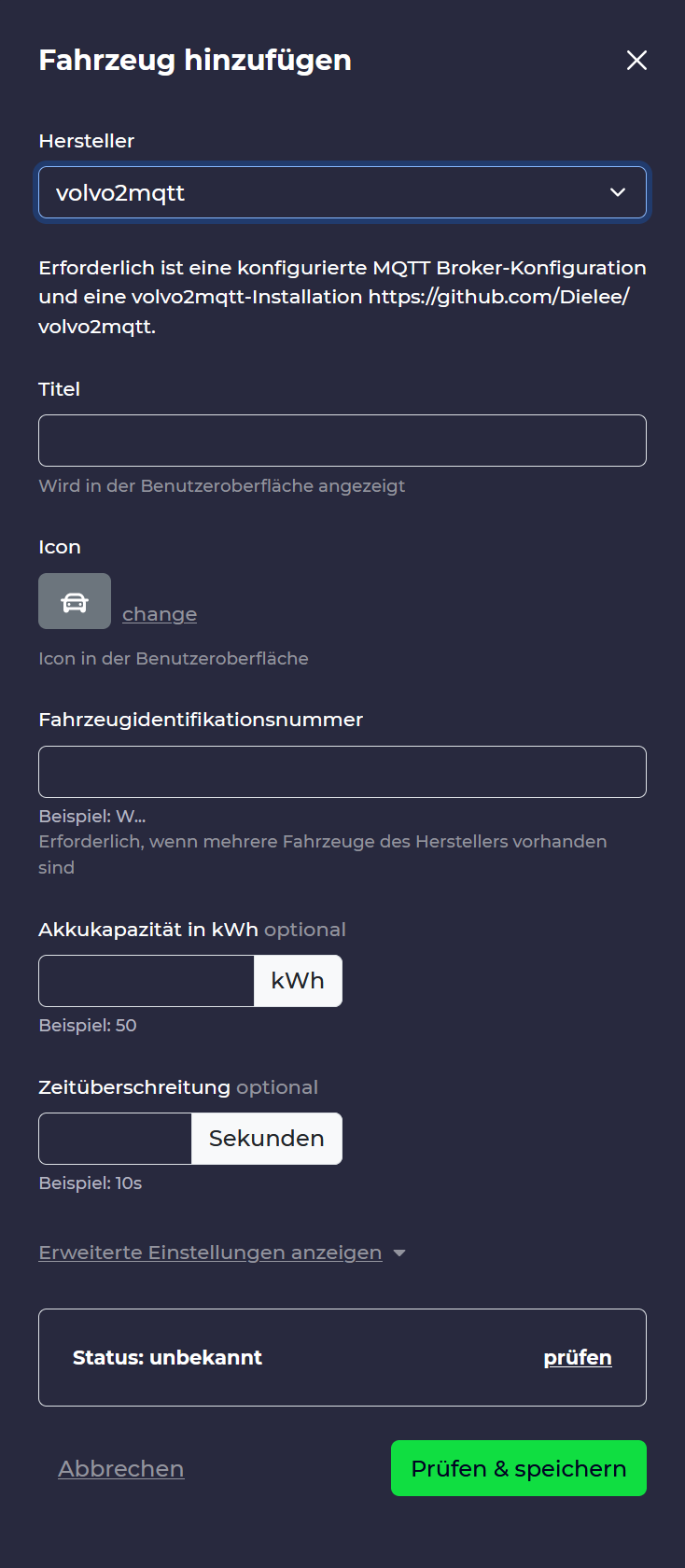

In the evcc configuration there’s a possibility to add a new car. It looks like this (sorry, my interface is in german language):

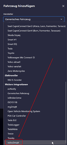

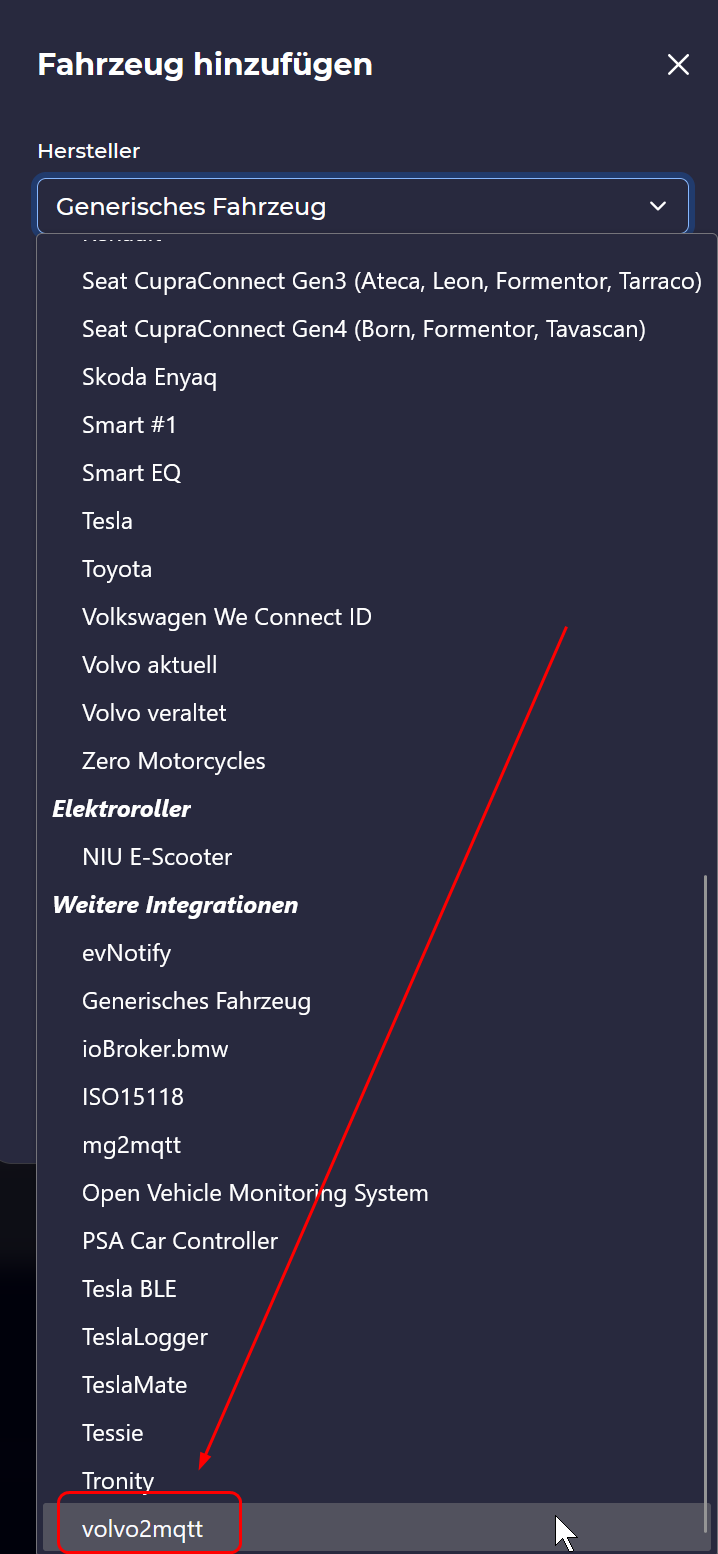

In the combobox there’s a list of integrations, which can be used and there I can find the volvo2mqtt integration:

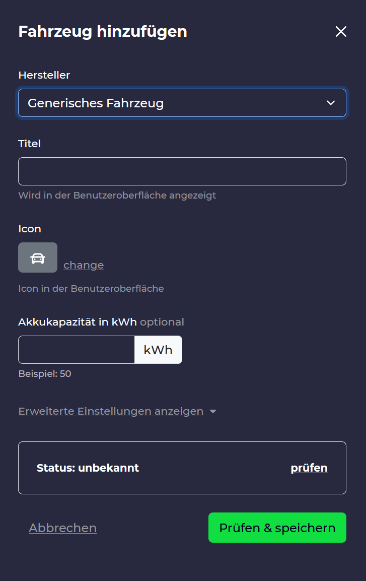

After choosing this integration, there are some fields to fill out and the car will be added:

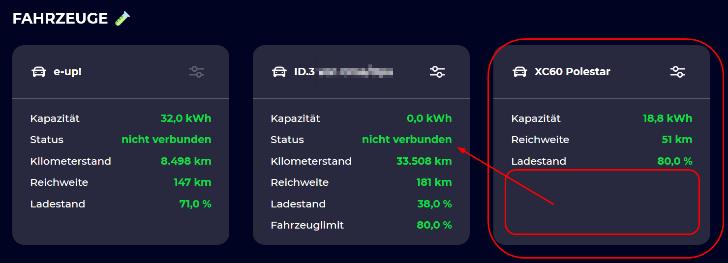

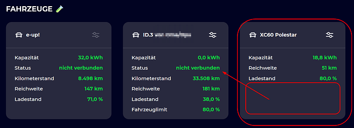

And here you can see the problem. The volvo2mqtt integration does not support all needed fields for evcc to decide, if the car is connected - and so evcc does not recognize the car automatically.

@dirsve I did not use EVCC to control charging as I’m using control directly on HA, but I have made some tests and apparently this worked fine here to get the car status , configuring vehicle on the yaml and using mqtt_statestream MQTT Statestream - Home Assistant
vehicles:
  - name: XC40
    title: XC40
    type: custom
    # Apesar de aceitar 3, aqui em casa considera somente 1
    phases: 1
    capacity: 69.452
# Capacity must be fixed value
#       source: mqtt
#       topic: homeassistant_out/states/sensor/volvo_XC40_battery_capacity/state
    soc:
      source: mqtt
      topic: homeassistant_out/states/sensor/volvo_XC40_battery_charge_level/state
    range:
      source: mqtt
      topic: homeassistant_out/states/sensor/volvo_XC40_distance_to_empty_battery/state
# https://github.com/evcc-io/evcc/blob/e93e42003745743af9ce58accd9de539609bba90/cmd/demo.yaml#L119
    status:
      source: go
# State A: Standby, when the EV is not connected
# State B: The EV is connected
# State C: The EV requests charging
# not all status considered here, only the ones that make sense for local control
      script: |
        if (system_status == "charging_system_charging") {
          "C"
        } else if (connection_status == "connection_status_connected_ac") {
          "B"
        } else {
          "A"
      in:
        - name: connection_status
          type: string
          config:
             source: mqtt
             topic: homeassistant_out/states/sensor/volvo_XC40_charging_connection_status/state
        - name: system_status
          type: string
          config:
             source: mqtt
             topic: homeassistant_out/states/sensor/volvo_XC40_charging_system_status/state
