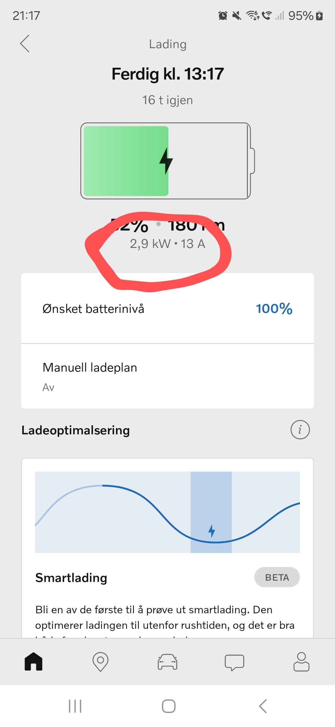

I wonder if charging speed in kW and A is possible to have as sensors?
No, the actual charging speed is not available in the API.
What will be available in a later version is the configured target battery level and the configured ampere limit.
It’s possible that they have access to more sensors than we do. The official app can also do stuff that is not available in the public API.
