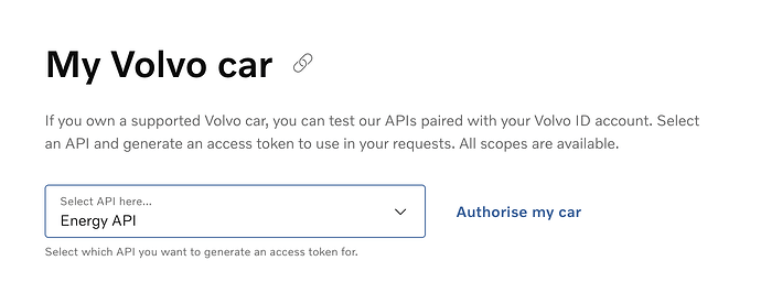

Seeing that you created a PR to improve the situation on the different API’s you are probably already much deeper into this.
But I assume you did see this allready?:
https://developer.volvocars.com/apis/docs/test-access-tokens/

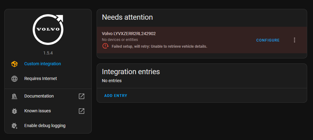

I saw that Australia was not on the list of supported countries. I just want to know if this is the likely reason, or I have done some other step wrong. Yes I have generated the API, [I did not ‘publish’ it] got the OTP etc. All good. However when I add my car to the application I get :
I guess you are just unlucky that Volvo doesn’t support Australia - yet. On the documentation page it is stated:
We are working to bring other regions online.
