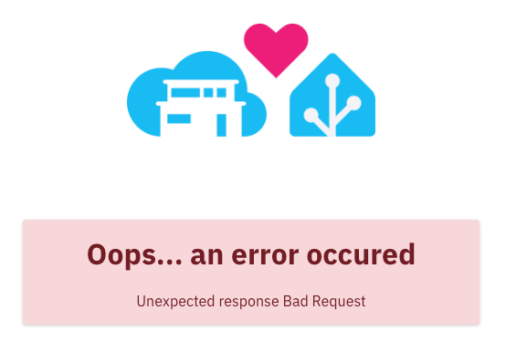

An update: it’s showing “authentication expired” again, and now when I try to reconnect, I get another “request for approval” screen. I click “allow access” and I see this:

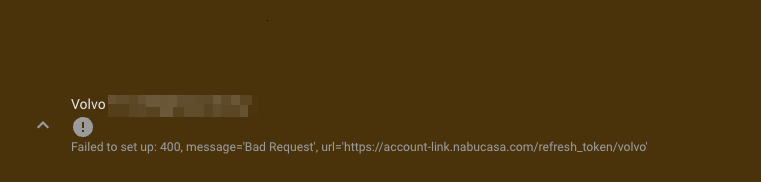

and this in the integration’s settings:
I’ve tried regenerating the API keys at Volvo’s end, but there does not seem to be a way of changing them in the integration. I’m not sure whether re-authenticating is the way you’re supposed to do this, but it needs to be possible (keys can get compromised and need to be cycled!)

If I publish the application on the Volvo portal, giving over a load of personal information that I did not want to give out, and follow the instructions, then I just get this instead:
Is there anyone out there who has got it to work, and stay working, and can tell me how they did it?

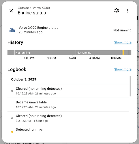

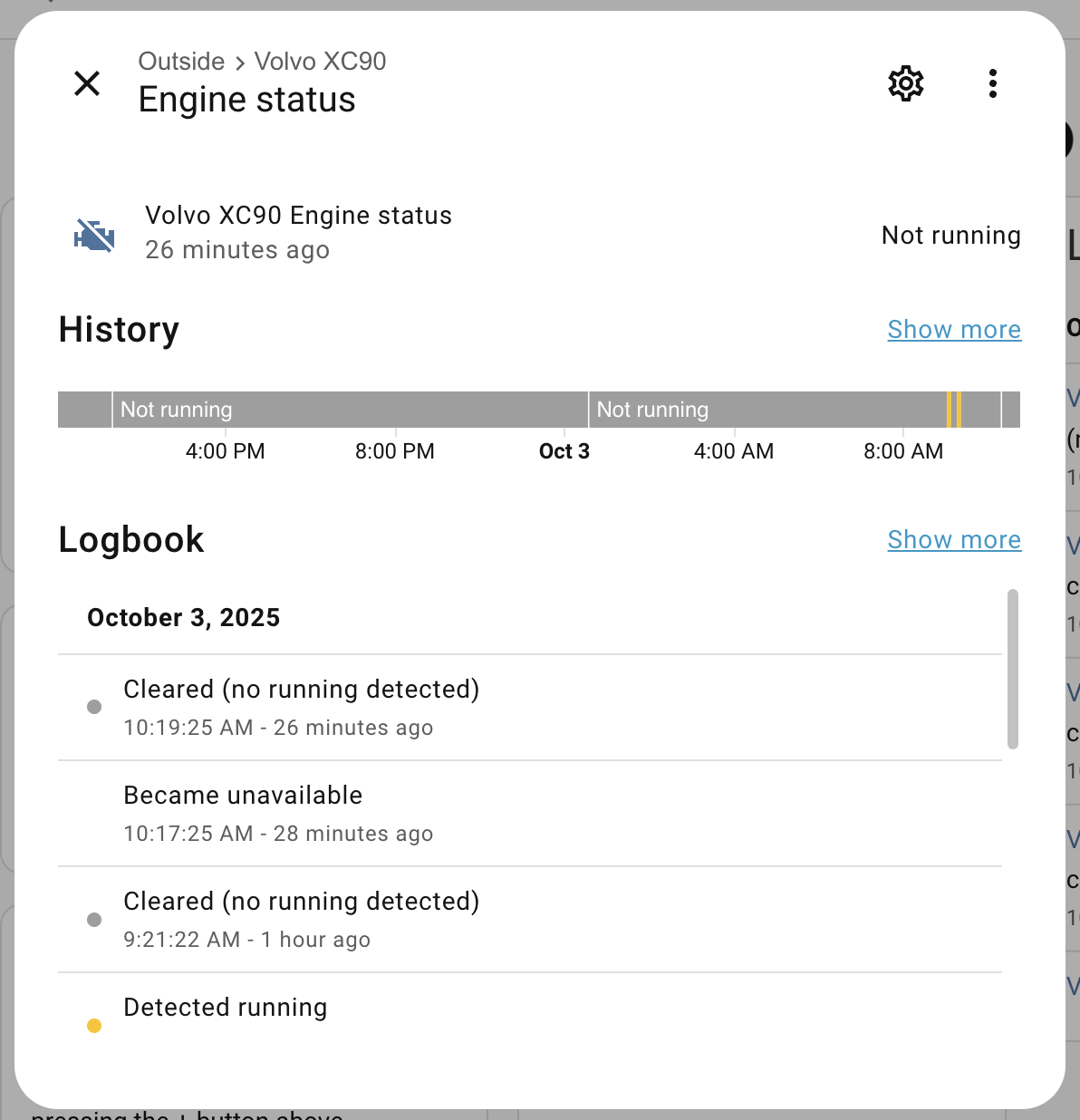

Just checked, and indeed the binary sensor switches to on in the HACS version of the integration. Same thing happens when it stops, the sensor turns off again. Side note, my car is a plugin hybrid, so it might be different with a combustion only.

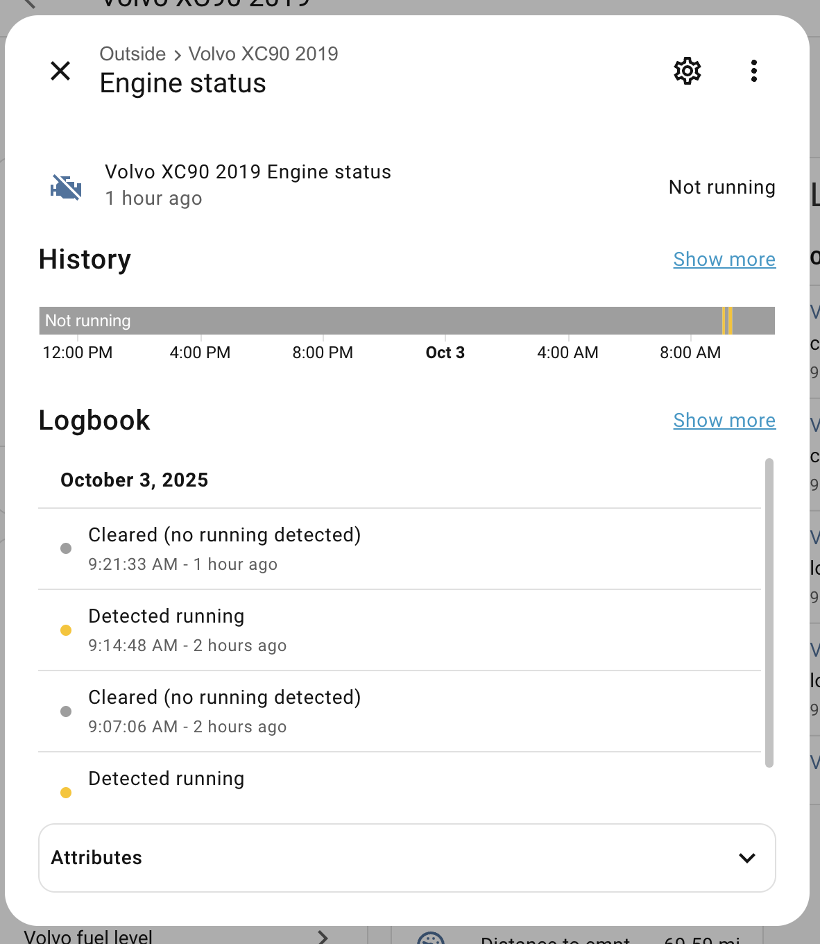

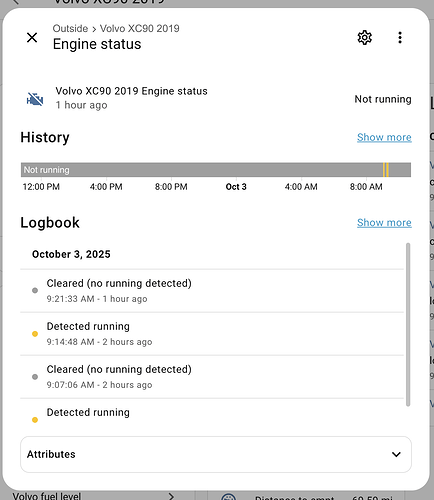

2019 XC90 (combustion). I just tested with the HACS version and after 15 minutes the Engine status never changed. I swear this used to work though.
I know it did actually - I don’t use the remote starter much in the summer. It’s more of a winter thing for me. I have an automation that alerts me if the engine starts and the garage door is closed (and the car is home etc) - and I know it’s triggered before (a number of times) when starting the car in the morning.
Just checking, was the engine actually running?
The more test results I receive, the better I can make the buttons or switch work as intended. So, don’t wait on anyone else please! :wink:
I tested again today with the same result. I confirmed the engine did start.
I’m wondering if maybe something strange happened because of timing?
I had just arrived home before testing, so the engine had only been off for maybe 3-5 minutes before starting it via remote start.
I remote started the car around 9:20-9:23-ish and let it run for the full 15 minutes.
HACS:
Core:
Side note: I have noticed the core module (which I configured yesterday), seems to become unavailable more often than the HACS version.
