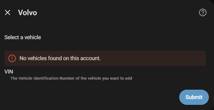

Hello. I did as you wrote. I added credentials, then added volvo integration in HA, and after accepting it on the Volvo website, I finally got the message in HA “No vehicles found on this account”. I tried deleting everything and restarting HA, but it didn’t help. HA version is 2026.4.1. I have Client ID, Secret and API Key, the app i publish. In log i have only “INFO (MainThread) [homeassistant.components.volvo.config_flow] Successfully authenticated.”
Any help?

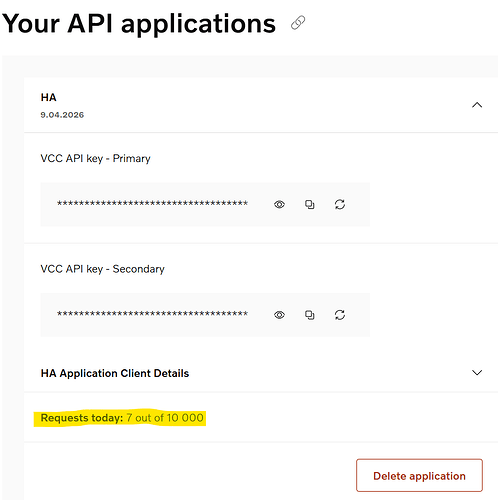

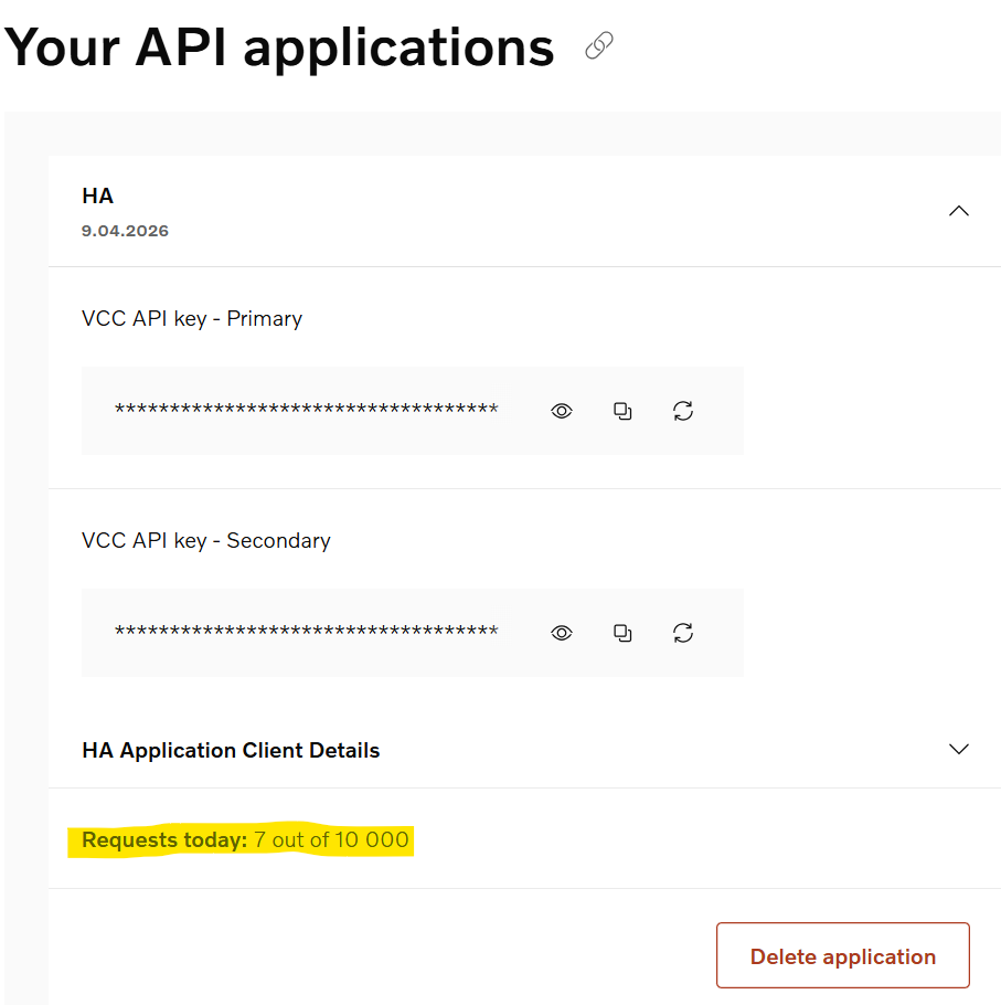

On the Volvo website I see that there are requests being sent
You must use volvocarsapi instead of homeassistant.components.volvo.api in the logger configuration. Then you’ll see the actual API requests.
