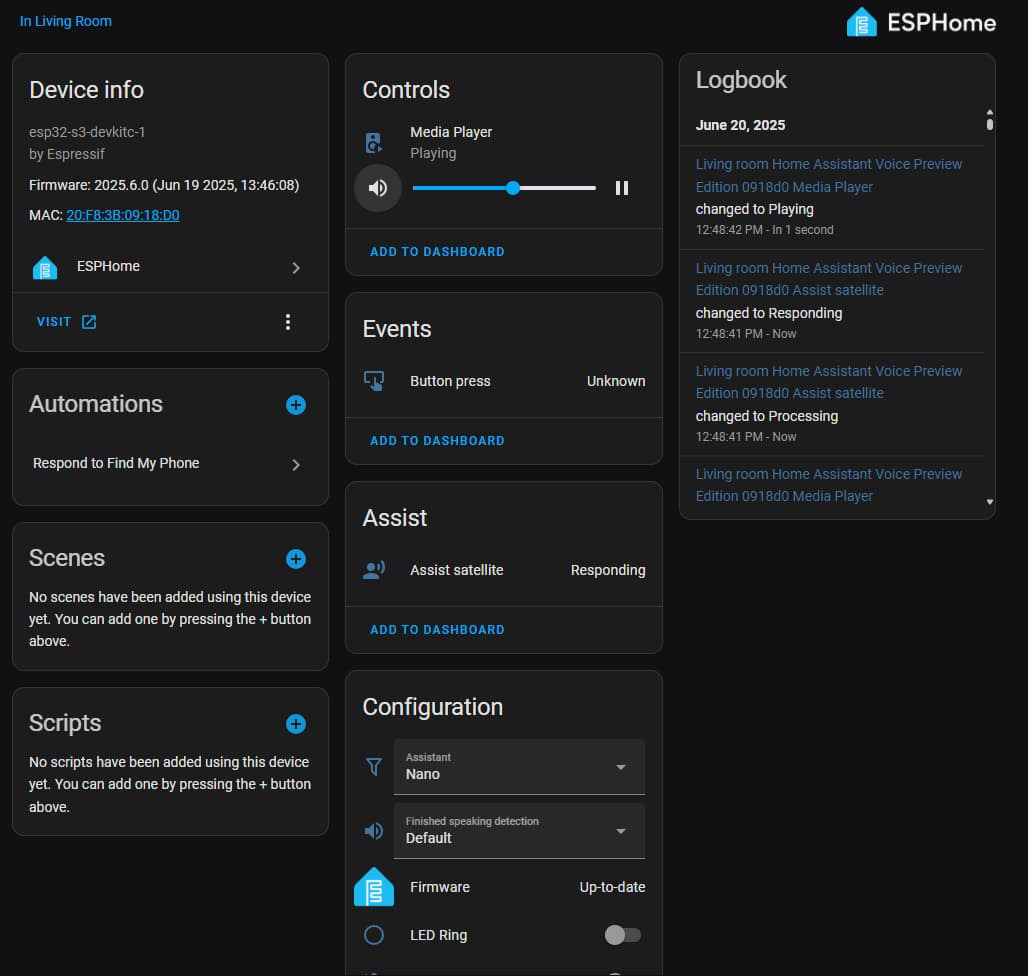

I’ve included a shot of my living room VPE as it’s responding. The Media Player icon changes to Playing, but alas no audio. You can see that the volume level is up and not muted.
