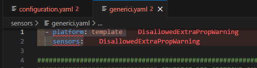

Since the latest version of VS Code,
I have strange errors.
Does this happen to you?
Help…

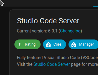

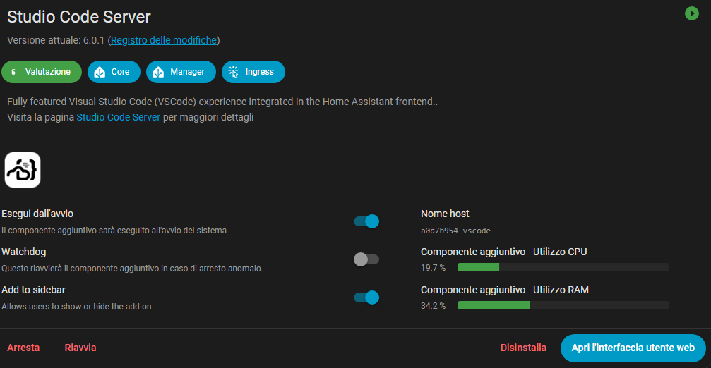

6.01 seems OK on mine, that’s the latest as far as I can tell.
Not Working… 6.0.1 updates!!!

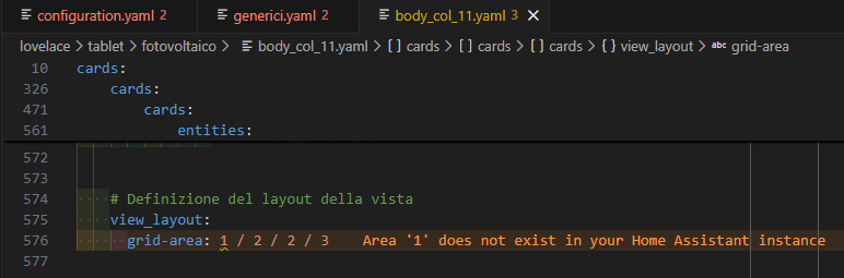

Line 23 in body_colq_11.yaml is an indenting error, should be indented more. That may account for the other errors.
Line 576 looks like a numerical value because it starts with a digit but is a string, that should be quoted.
Isn’t it great when the editor actually points out your errors?

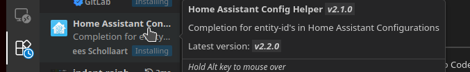

Well if you go to the extensions and turn off the homeassistant extension that should remove all the HA linting.
OK, maybe true, but I don’t understand why it works so well…
For the other two errors, I saw a report on GitHub…
