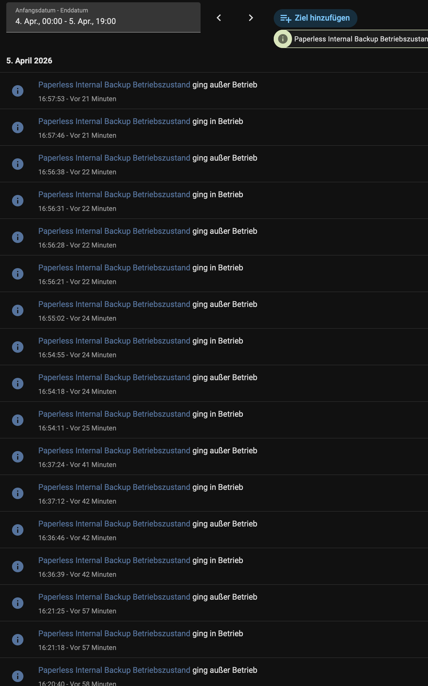

I have the duplicati integration installed and have two locations defined to make backups of my paperless folder. Now there are buttons for triggering a backup and I want to start the first backup and wait for it to finish without errors. After the first backup finished I want to start the second backup and do the same thing. There are two binary sensor for each backup instance ( operating state and backup state).

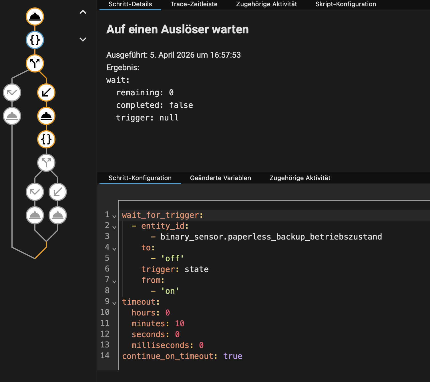

Now I created a script with a wait_for_trigger. I press the first button and then check for the operating state to change from “operating” to “idle” (aka on to off). I also added a timeout of 15 minutes.
Normally a backup will take a couple of minutes. However if I trigger this multiple times in a row, there is no change to be done by duplicati and the operating state will change from off to on and from on to off in a couple of seconds (but it always changes).
Now what I can see in the traces is that there is never a “trigger” and each wait_for_trigger block stuck in the “timeout” block. I dont understand why the trigger is not fired. Can anyone help? Sorry I set by Home Assistant to German language.

You have the mode of the automation set to “restart”, so every time you “trigger” the script it cancels the previous run and starts a new one.
Check the timing of the state change, if the state changes before the automation reaches the Wait step then there is no trigger event… you’ll need to use a Wait for Template instead.

In a Wait for Template the template is evaluated when the action starts and is reevaluated based on the contents of the template… when the states of entities used within the template update or at specific time intervals. So if the state changed to “off” before the Wait action starts, the wait will be completed immediately.
In a Wait for Trigger the trigger listener is set when the action starts. If the state is “off” when that listener is set, the state needs to change from “off” to “on”, then back to “off”.
What you are describing is a State trigger, so you were using the generally correct tool… it just may not work for this specific case.
