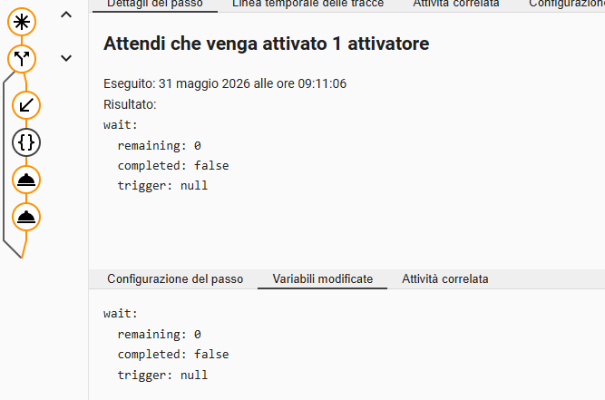

In the last trace I can see that wait_for_trigger triggers the timeout:

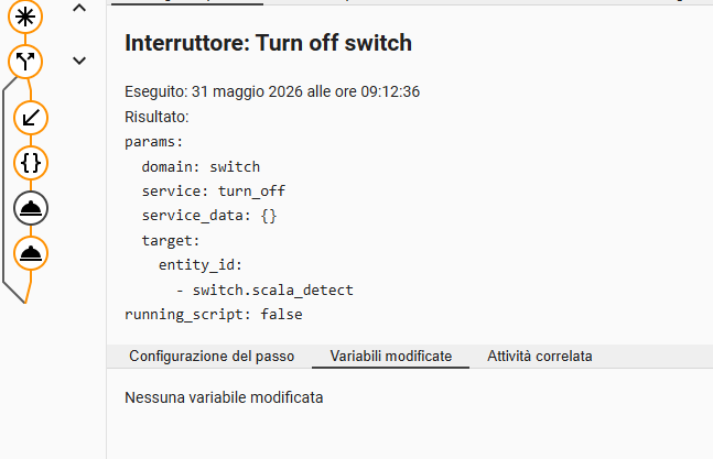

But by the way the script has continued the execution after the timeout (09:11:06 + 1min 30sec = 09:12:36):

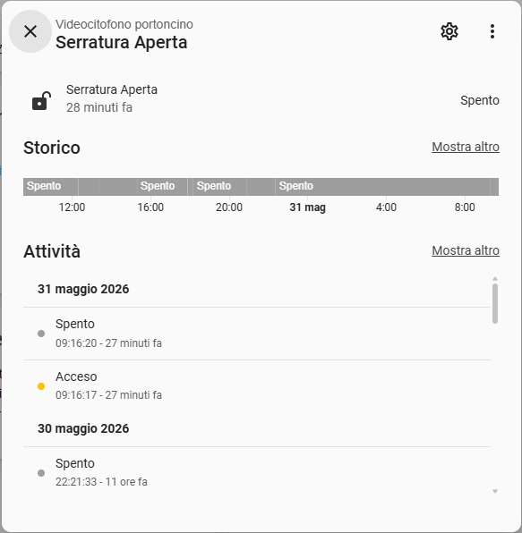

And also, the lock was not opened in the meantime, but afterward:
Why this?
