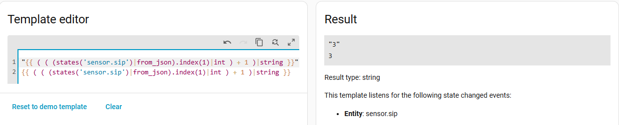

When I enclose in " "
- data:
          value: "{{ ( ( (states('sensor.sip')|from_json).index(1)|int ) + 1 )|string }}"
The result is “IndexValue” *with quotes), which doesn’t work downstream, instead of IndexValue (without quotes). And if that were the case, why did the succesful evaluation work? Note putting quotes around the succesful evaluation also produced “IndexValue”
It should not create the quotes with that code.
Only if you did both quotes and the >- and new line will that happen
I agree that it should not create quotes, but that doesn’t change the fact that it does.
I refuse to believe there is something that dysfunctional in your install.
This is something that has not changed in many many years, or perhaps ever.
If you are right then it’s a major issue with the yaml decoder and/or Jinja.
Yeah, I had a hard time with my assertion, too, so I recreated the conditions and, lo and behold, no quotes. mea culpa!
But I did put the template into the Settings–>Developer tools–>Template–>Template editor The result with quotes produces quotes and no quotes without.
The template editor works differently than the automation engine when it parses the jinja.
The automation interpreter expects quotes on a single line template to denote the beginning and end of the template.
the template editor has no requirement and parses the templates exactly as written. so when you add quotes outside of the template there then the editor just renders them as a string character before and after the template result just as it would with any other string character.
What is “adding the quotes” I believe that’s the disconnect here.
