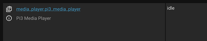

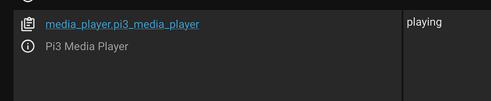

Checking the state when some TTS is playing via announce shows it in idle throughout the entire announcement.
OK looks like the TTS action (which requires an entity - but at least I know how to do that)… does change media player state.
Nope - it doesn’t reliably go from playing to idle after TTS. Back to the drawing boards. i actually think that’s a Satellite issue and might explain why it’s getting “stuck” a lot in other automations.

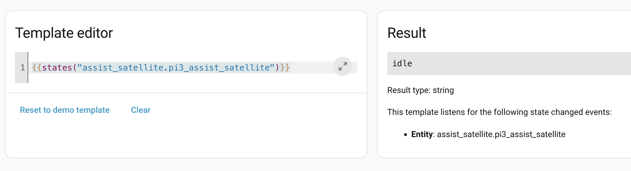

OK - some learnings:
{{states("assist_satellite.pi3_assist_satellite")}} seems to cycle through…
idle
listening
processing
responding
With two exceptions being:
  • Where VA expects a followup input prompt where it goes back to listening. E.g. no intent hit for automation, so it tries to clarify (expected).
  • Randomly sits in processing after TTS action in automation is played back (inexplicable). This; I think, explains a lot of the inconsistent behavior waiting for a TTS prompt to “complete”, to move on to the next action.
Media Player state is even more unreliable.
Edit: Further to this I have observed Ollama based VA sometimes tries to handle the query even when it matches the intent for an automation word-for-word. Is there a technique to achieve some level of priority/consistency?
