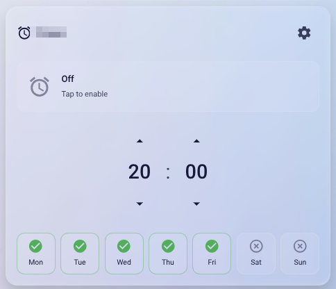

Alarm Card:

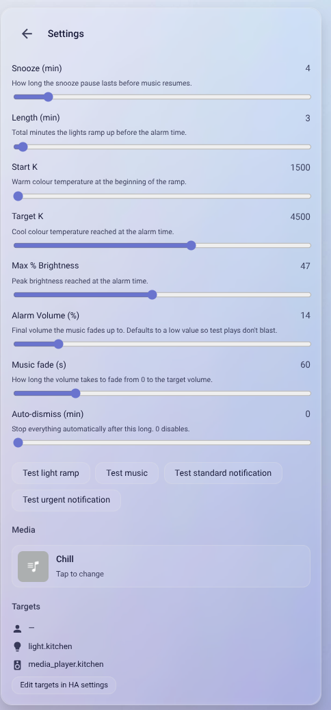

Setup Card:

  • Lights ramp linearly from warm + dim to cool + bright over a configurable duration, ending at your alarm time. 20 steps/min by default;
  • Never dims a light below its current brightness, so if you brighten the room mid-ramp it stays.
  • Music fades in from 0 to a configured volume at alarm time, with a random 1–4 track-skip so each fire (and each snooze) starts on a different track from your favourite — not always track 1.
  • Multi-room playback for speakers that advertise the GROUPING feature (Sonos tested, with all the unjoin / 3-second wait / volume-zero / join / shuffle / settle dance baked in).
  • Mobile notifications with standard and urgent (critical) paths — distinct iOS interruption-levels and Android channels so you can give them different sounds.
  • Standard gives a phone option to click snooze
  • Critical bypasses Do Not Disturb if the speaker fails to play or no media has been picked yet.

  • Custom Lovelace card with day-of-week toggles, time picker, and an in-card media browser. Single HACS install (Integration only) — the card ships inside the integration and auto-registers as a Lovelace resource.
