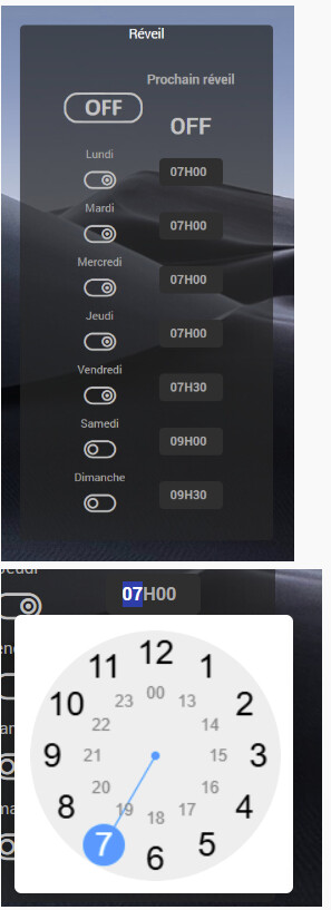

I’m a beginner with HA.
This topic interests me How to create the alarm clock in HASS? - #68 by jimmyeao.

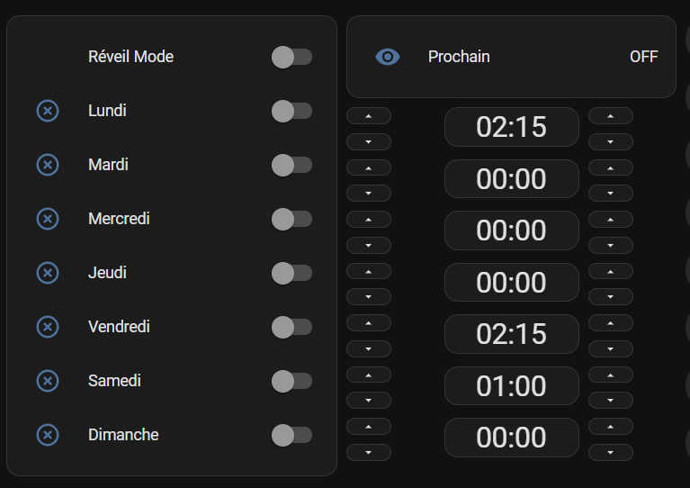

I’m trying to recreate the alarm clock I had on Jeedom.
So I did this:
square: false
type: grid
columns: 2
cards:
  - type: entities
    entities:
      - entity: input_boolean.reveil_mode
      - entity: input_boolean.reveil_lundi
      - entity: input_boolean.reveil_mardi
      - entity: input_boolean.reveil_mercredi
      - entity: input_boolean.reveil_jeudi
      - entity: input_boolean.reveil_vendredi
      - entity: input_boolean.reveil_samedi
      - entity: input_boolean.reveil_dimanche
    show_header_toggle: false
  - type: vertical-stack
    cards:
      - type: entities
        entities:
          - entity: sensor.reveil_prochain_reveil
          - entity: input_datetime.reveil_heure_lundi
          - entity: input_datetime.reveil_heure_mardi
          - entity: input_datetime.reveil_heure_mercredi
          - entity: input_datetime.reveil_heure_jeudi
          - entity: input_datetime.reveil_heure_vendredi
          - entity: input_datetime.reveil_heure_samedi
          - entity: input_datetime.reveil_heure_dimanche
        state_color: false
title: Réveil
I find the “hours” section ugly, especially since, contrary to what I’ve seen, I need a different schedule. per day.
Could you help me make something a bit nicer for selecting schedules?
I thought about doing something like this [07 ↑↓] [30 ↑↓] but I can’t get it to work.
Thank you for your valuable help.
Since I could only post one image per message, here’s what I did on the Jeedom side:

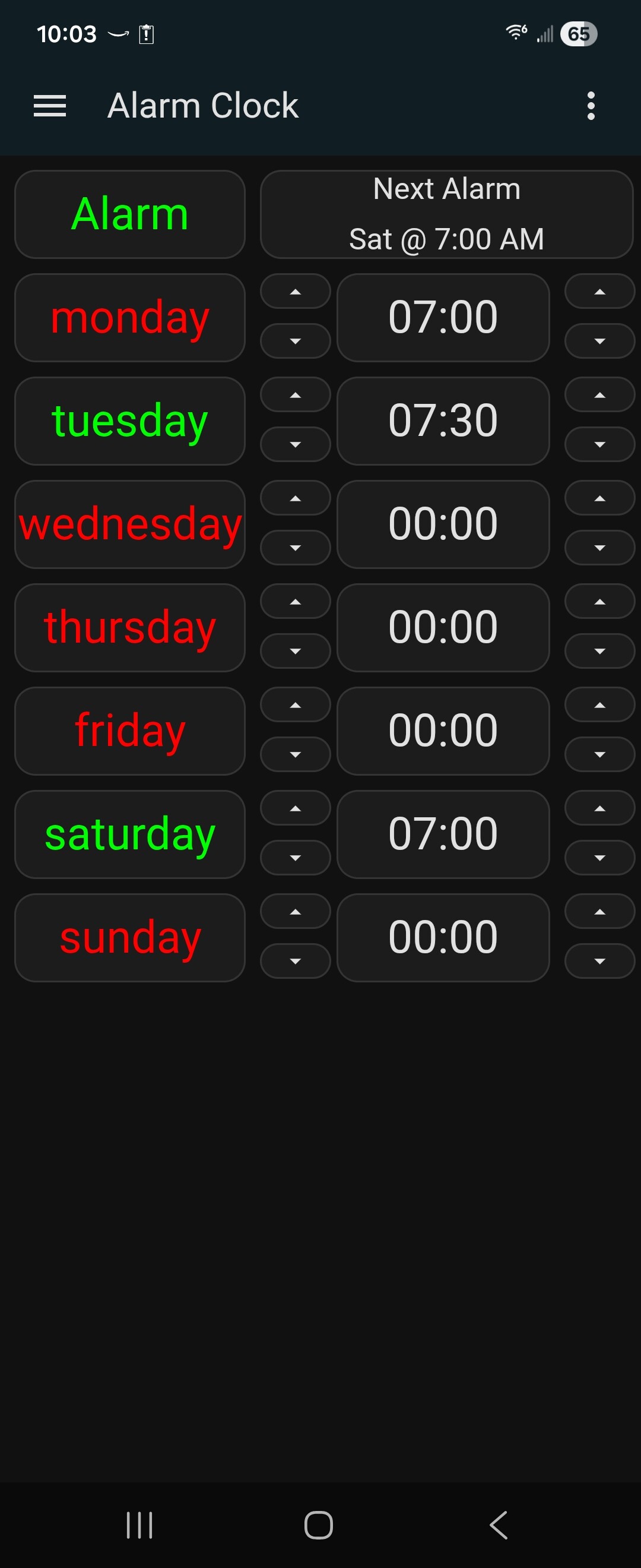

Okay. This sounded like fun. So, I took a stab at it.
Back-end processing still needs built to set the next alarm helper and handle the alarm going off.
But, here is the front-end I came up with.
Tapping the Alarm button toggles the whole thing off and on. Tapping each day button toggles that day off an on. Up and down arrows for each day’s hour and minute. The minute goes in 15 minute increments. But, that could easily be changed.
Perfect, I’d like the YAML code.
So, this uses:
custom:button-card link
custom:decluttering-card link
Setup eight input_boolean helpers:
input_boolean.alarm_clock
input_boolean.alarm_clock_monday
input_boolean.alarm_clock_tuesday
input_boolean.alarm_clock_wednesday
input_boolean.alarm_clock_thursday
input_boolean.alarm_clock_friday
input_boolean.alarm_clock_saturday
input_boolean.alarm_clock_sunday
And, eight input_datetime helpers:
input_datetime.alarm_clock - this one is Date and Time
input_datetime.alarm_clock_monday - time only
input_datetime.alarm_clock_tuesday - time only
input_datetime.alarm_clock_wednesday - time only
input_datetime.alarm_clock_thursday - time only
input_datetime.alarm_clock_friday - time only
input_datetime.alarm_clock_saturday - time only
input_datetime.alarm_clock_sunday - time only
Of course, you can name these how you want. If you only change the name of the day to match your language, the only change in the card will be the variable when calling the decluttering template. Once you have your days in there, you can resize the button with the day in it as needed.
The raw card yaml is
Summary
decluttering_templates:
  alarm_clock_day:
    card:
      cards:
        - type: horizontal-stack
          cards:
            - type: custom:button-card
              entity: input_boolean.alarm_clock_[[day_of_week]]
              tap_action:
                action: toggle
              state:
                - value: 'off'
                  styles:
                    name:
                      - color: red
                - value: 'on'
                  styles:
                    name:
                      - color: lime
              show_state: false
              show_icon: false
              styles:
                card:
                  - width: 130px
                  - height: 50px
                  - padding: 0
                name:
                  - transform: scale(1.5)
              cards:
                  entity: input_datetime.alarm_clock_[[day_of_week]]
                  icon: mdi:menu-up
                  show_name: false
                  variables:
                    newhour: |
                        if (states[entity.entity_id].attributes.hour == 23) {
                          return 0;
                        } else {
                          return states[entity.entity_id].attributes.hour + 1;
                    hour: |
                        if (variables.newhour < 10) {
                          return `0${variables.newhour}`;
                        } else {
                          return `${variables.newhour}`;
                    minute: |
                        if (states[entity.entity_id].attributes.minute < 10) {
                          return `0${states[entity.entity_id].attributes.minute}`;
                        } else {
                          return `${states[entity.entity_id].attributes.minute}`;
                  tap_action:
                    action: call-service
                    service: input_datetime.set_datetime
                      entity_id: input_datetime.alarm_clock_[[day_of_week]]
                      time: >-
                        [[[ return `${variables.hour}:${variables.minute}:00`
                  styles:
                    card:
                      - width: 40px
                      - height: 20px
                      - padding: 0
                  icon: mdi:menu-down
                  show_name: false
                  variables:
                    newhour: |
                        if (states[entity.entity_id].attributes.hour == 0) {
                          return 23;
                        } else {
                          return states[entity.entity_id].attributes.hour - 1;
                    hour: |
                        } else {
                    minute: |
                        } else {
                  tap_action:
                      time: >-
                  styles:
                    card:
                      - width: 40px
                      - height: 20px
                      - padding: 0
              tap_action: none
              show_icon: false
              variables:
                hour: |
                    if (states[entity.entity_id].attributes.hour < 10) {
                      return `0${states[entity.entity_id].attributes.hour}`;
                    } else {
                      return `${states[entity.entity_id].attributes.hour}`;
                minute: |
                    } else {
              name: '[[[ return `${variables.hour}:${variables.minute}`; ]]]'
              styles:
                card:
                  - width: 120px
                  - height: 50px
                  - padding: 0
                name:
              cards:
                  icon: mdi:menu-up
                  show_name: false
                  variables:
                    newminute: |
                        if (states[entity.entity_id].attributes.minute == 45) {
                          return 0;
                        } else {
                          return states[entity.entity_id].attributes.minute + 15;
                    minute: |
                        if (variables.newminute < 10) {
                          return `0${variables.newminute}`;
                        } else {
                          return `${variables.newminute}`;
                    hour: |
                        } else {
                  tap_action:
                      time: >-
                  styles:
                    card:
                      - width: 40px
                      - height: 20px
                      - padding: 0
                  icon: mdi:menu-down
                  show_name: false
                  variables:
                    newminute: |
                        if (states[entity.entity_id].attributes.minute == 0) {
                          return 45;
                        } else {
                          return states[entity.entity_id].attributes.minute - 15;
                    minute: |
                        } else {
                    hour: |
                        } else {
                  tap_action:
                      time: >-
                  styles:
                    card:
                      - width: 40px
                      - height: 20px
                      - padding: 0
views:
  - title: Alarm Clock
    icon: mdi:clock
    badges: []
    type: custom:masonry-layout
    layout:
      width: 240
    cards:
        cards:
            cards:
                tap_action:
                  action: toggle
                state:
                  - value: 'off'
                    styles:
                      name:
                        - color: red
                  - value: 'on'
                    styles:
                      name:
                        - color: lime
                show_state: false
                show_icon: false
                styles:
                  card:
                    - width: 130px
                    - height: 50px
                    - padding: 0
                  name:
                label: Next Alarm
                show_label: true
                show_icon: false
                    if (helpers.formatDateYear(states[entity.entity_id].state) != '2000')
                      return `${helpers.formatDateWeekdayShort(states[entity.entity_id].state)} @ ${helpers.formatTime(states[entity.entity_id].state)}`
                    else
                      return 'None';
                tap_action: none
                styles:
                  card:
                    - width: 210px
                    - height: 50px
                    - padding: 0
                  grid:
                    - grid-template-areas: '"l" "i" "n" "s"'
                    - grid-template-rows: min-content 1fr min-content min-content
                    - grid-template-columns: 1fr
          - type: custom:decluttering-card
            template: alarm_clock_day
            variables:
              - day_of_week: monday
            variables:
              - day_of_week: tuesday
            variables:
              - day_of_week: wednesday
            variables:
              - day_of_week: thursday
            variables:
              - day_of_week: friday
            variables:
              - day_of_week: saturday
            variables:
              - day_of_week: sunday
The decluttering card contains a day worth of code. It is used seven times in the dashboard with a variable for the day name.
Let me know if you have any questions.

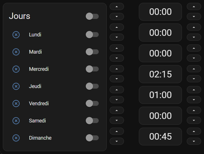

Thank you so much :slight_smile:
What interests me is the mechanism for incrementing and decrementing the times.
We agree that this is the part:
              tap_action: none
              show_icon: false
              variables:
                hour: |
                    } else {
                minute: |
                    } else {
              styles:
                card:
                  - width: 120px
                  icon: mdi:menu-up
                  show_name: false
                  variables:
                    newminute: |
                          return 0;
                        } else {
                    minute: |
                        } else {
                    hour: |
                        } else {
                  tap_action:
                      time: >-
                  styles:
                    card:
                      - width: 40px
                      - height: 20px
                      - padding: 0
                  icon: mdi:menu-down
                  show_name: false
                  variables:
                    newminute: |
                          return 45;
                        } else {
                    minute: |
                        } else {
                    hour: |
                        } else {
                  tap_action:
                      time: >-
                  styles:
                    card:
                      - width: 40px
                      - height: 20px
                      - padding: 0
You are showing the button that displays the time followed by the two buttons that increment and decrement the minutes. There are two buttons above that to increment and decrement the hours.
So, yes. That also allows the hours/minutes to roll in the case of going above or below the min/max for each part of the time.
Thank you so much, it’s starting to look like something :slight_smile:
Okay. To finish what I started …
An automation and a script will close this.

I think it’s ugly.
I can’t seem to make anything nice.
I agree. I thought what I came up with looks better. Just my unbiased (LOL) opinion.
Can you come up with something that is a mix of the two? Or, explain what you would like it to look like different from the two.
We got some smart folks here that can help!
I started by chasing the pic in your second post. But, decided I liked where mine went better. Just saying.
Thanks, I’m looking for something very minimalist, without red/green colors… Something like what I showed, but smaller (smartphone display) and simple.
You can certainly change what I did to have toggles instead. It will take some digging to make the buttons look like toggles.
Not sure how skinny your phone is, but my screenshot above was on my phone.

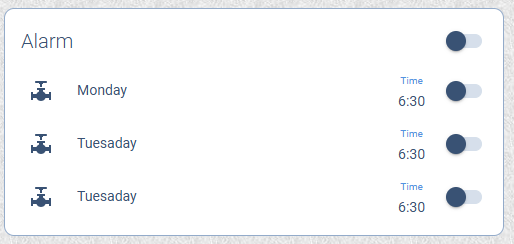

Maybe try putting all the day’s entities in the same row using this card:
Here’s a mock-up I threw together with some of my entities:
You have to click on the time to edit it.
entities:
  - entity: switch.zone_1
    type: custom:multiple-entity-row
    toggle: true
    state_color: true
    entities:
      - entity: input_datetime.blinds_weekday_open_time
  - entity: switch.zone_2
    toggle: true
    state_color: true
    entities:
  - entity: switch.zone_3
    toggle: true
    state_color: true
    entities:
title: Alarm
type: entities
show_header_toggle: true
Are multiple Tuesadays a southern hemisphere thing? :grin:
Yes. Yes they are. Especially after a sleepless night out aurora watching.
Here I am thinking it was Tuesday

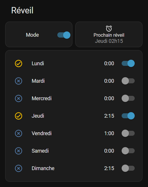

And there you go, thank you very much for your advice, I used multiple-entity-row.
cards:
    cards:
      - type: entities
        entities:
            toggle: true
            icon: false
        card_mod:
          style: |
            ha-card {
              height: 70px !important;
              display: flex;
              align-items: center;
              padding: 0 px !important;
            .card-content {
              width: 100%;
        icon: mdi:alarm
        show_state: true
        layout: vertical
        styles:
          card:
            - padding: 8px
            - font-size: 12px
            - height: 70px
          name:
            - font-size: 13px
          state:
            - font-size: 14px
            - color: var(--secondary-text-color)
  - type: entities
    entities:
        toggle: true
        state_color: true
        entities:
        toggle: true
        state_color: true
        entities:
        toggle: true
        state_color: true
        entities:
        toggle: true
        state_color: true
        entities:
        toggle: true
        state_color: true
        entities:
        toggle: true
        state_color: true
        entities:
        toggle: true
        state_color: true
        entities:
title: Réveil
