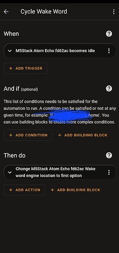

I have found a work around for this exact issue.
Set up an automation.
The trigger is when the “device” (the Atom M5) goes to “idle”.
The action is to set the wake word location to where it already is. In my case it was “In Home Assistant”. In my case this was the top or first option.
So trigger is when m5 goes idle and action is to set wake word location to “first”.
Well, thanks a lot. This works. Greetings, Horst.
