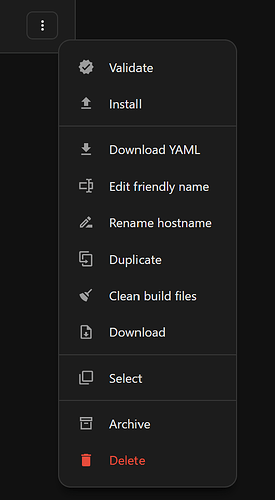

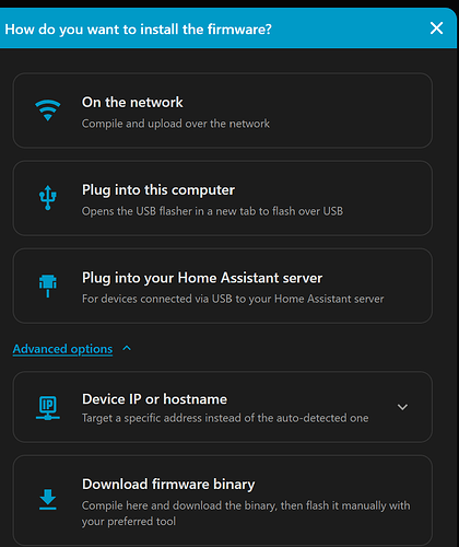

From the 3 dots on the device in ESPHome, you select install and manual download to install the bin file but this overwrites what you already have flashed.

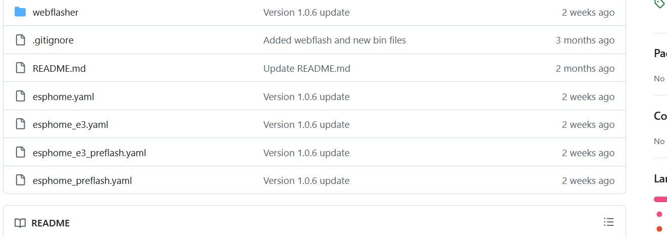

Or you can add this device to your esphome and just c/p yaml settings from their github file to your config and then just upload it to device.

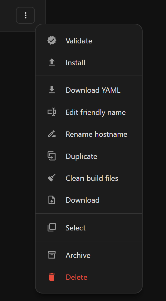

These are my '3 dots' options in esp device builder - i've no manual download. Do i need the last one on the list, and it will let me choose the .bin i already have?
Check Daniel's post!

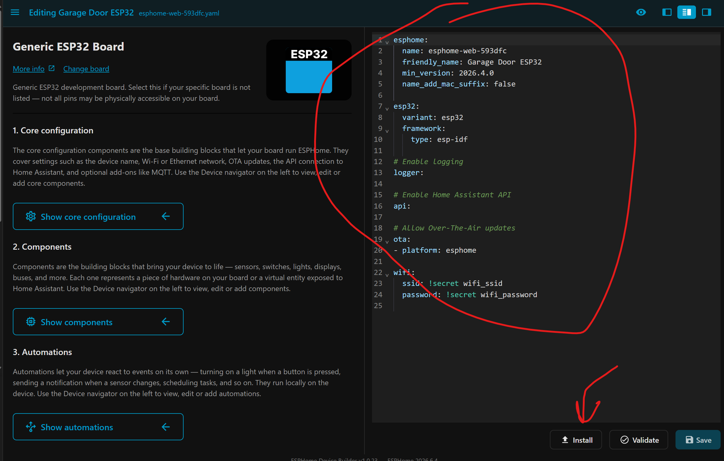

OK i see that now - so do i hit edit on the device in esp device builder, paste in the area below then hit upload? and cross my fingers too i assume?!
Yes, flashing will not go through if there are errors and you are informed about them so you can correct what is wrong.

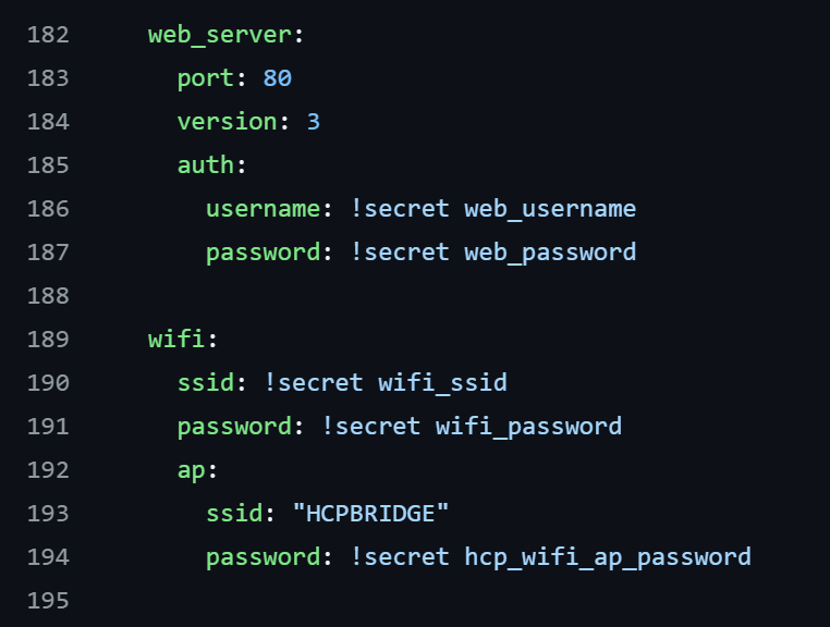

OK - i will give that a go tomorrow. One last question before i try it then - how do i handle these 'secret' credentials when i paste it in? I am aware of the existence of such things in HA but have never knowingly got involved with them.
In ESPHome, in the top right corner, the programs' 3 dots gives you the option to store those secrets so you can address them in the board config.
Perfect i see it, thanks. I will report back with how it goes!

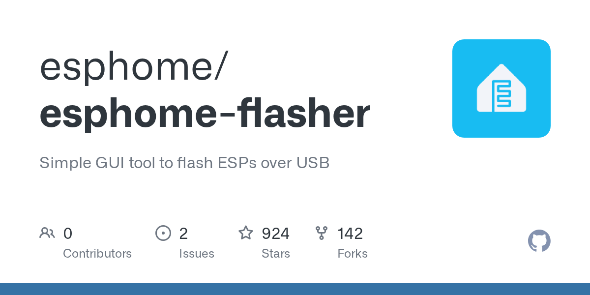

A much simpler option is to connect your ESP device directly to a Windows PC then use this tool to upload the .bin file:
It is depreciated in favour of the web flashing tools but it still works perfectly.
