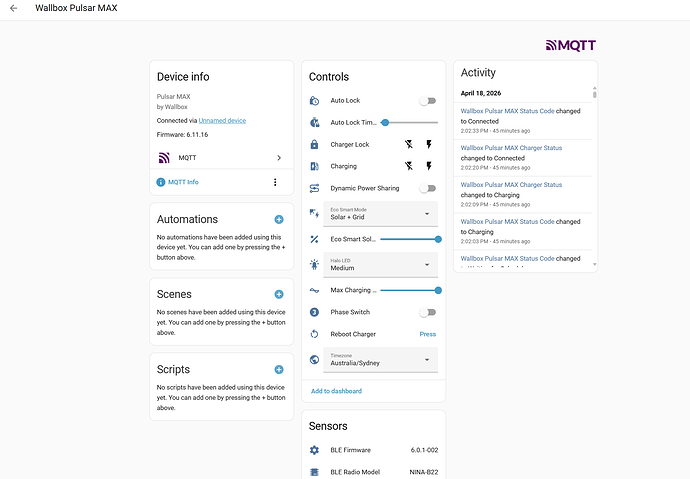

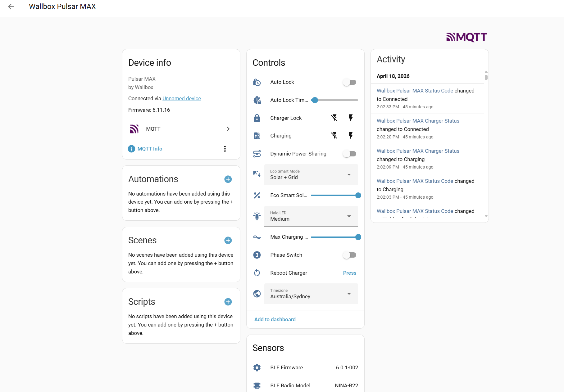

Home Assistant picks it up automatically via MQTT discovery.
HA out of the box (~30 entities):

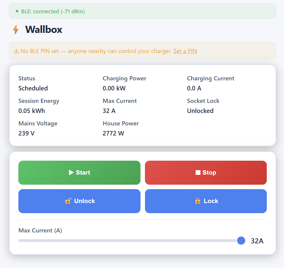

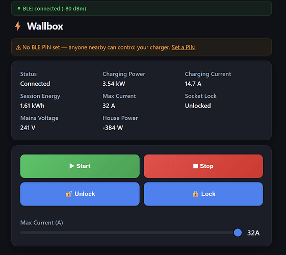

  • Start / stop charging, lock / unlock
  • Live power, current, voltage, session kWh
  • Lifetime Energy sensor wired for the HA Energy dashboard

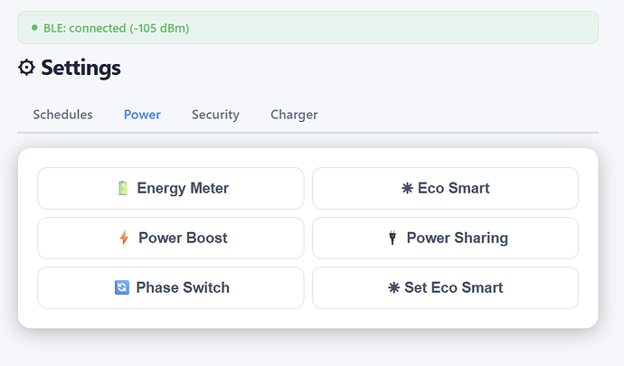

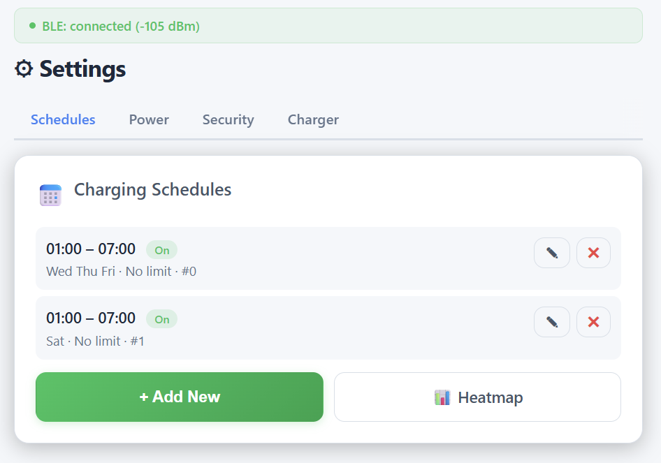

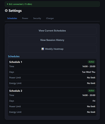

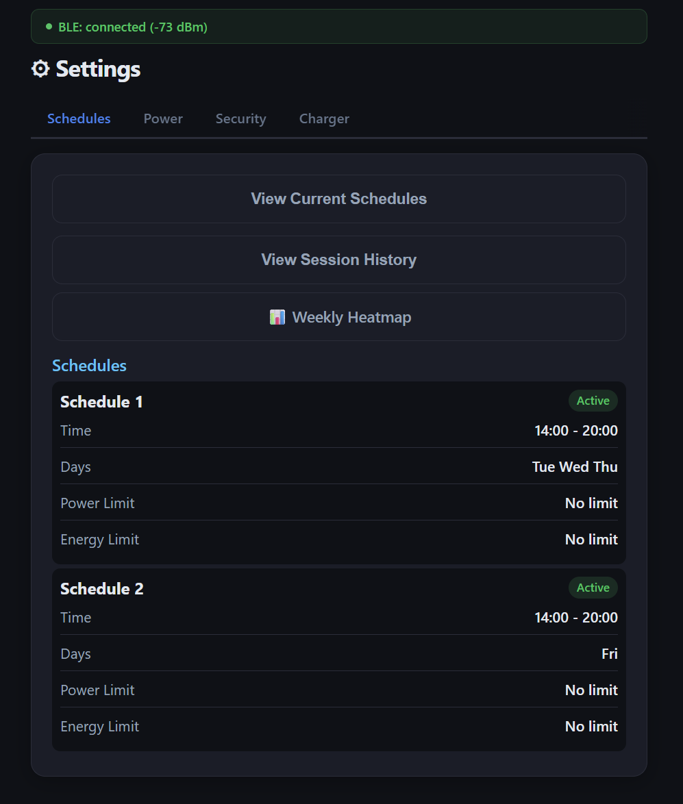

  • Schedule editor, Eco Smart mode, Phase Switch, Halo LED, Auto Lock, OCPP

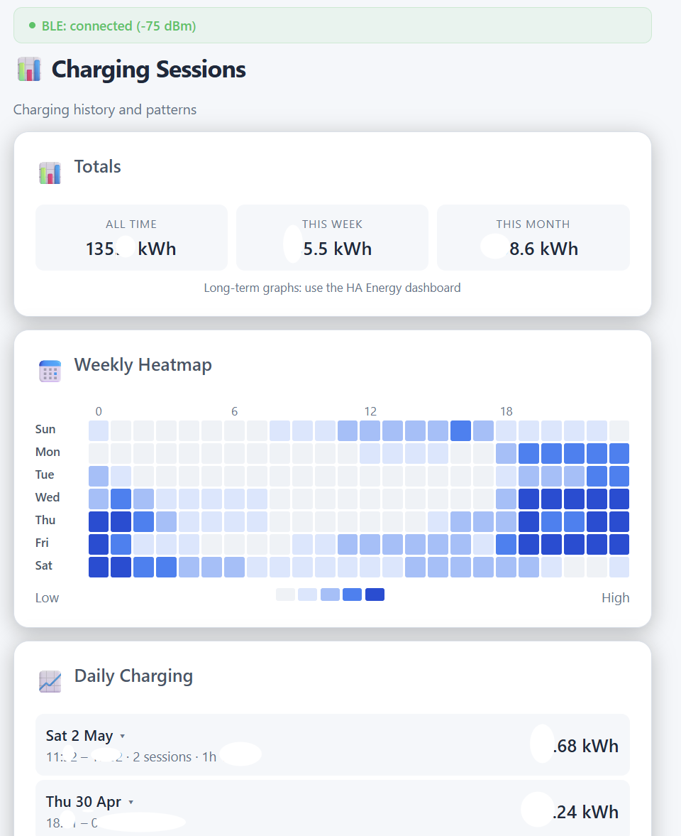

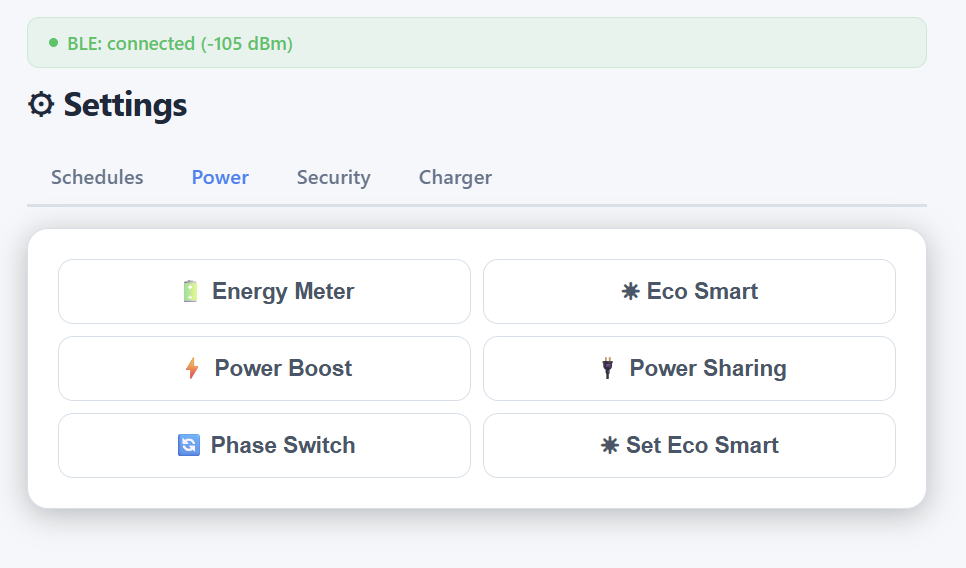

Also a self-hosted web UI on the ESP32 itself — captive-portal first-boot,
weekly heatmap with click-to-drill-down, daily charging totals (groups
solar/eco-smart pause/resume cycles into one plug-in event), CSV export of
session history, and a “Release BLE for app” button so you can pop into
the official Wallbox app without rebooting the gateway.

May I ask if this can manage the power charging control, modifying the current in real-time?
Thank you. Please do! There is a slider for the current. Im not sure how the Wallbox handles a max current change when already charging.
You could try modifying current using a HA automation and see if it works, or change current while its charging with the slider. This has not been tested so do so at your own risk! But I believe its a standard Wallbox feature to alow for tarrif changes or solar production changes.

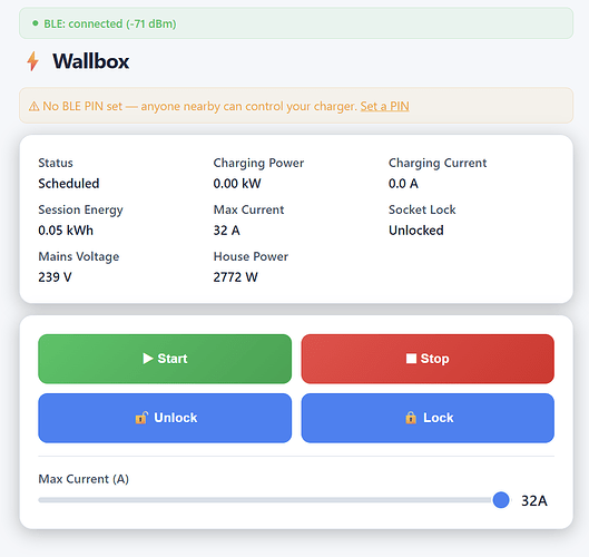

v2.2.0 just shipped — biggest release since launch:
:electric_plug: WebSocket live dashboard — no more 10-second polling lag. Web UI
tiles update the instant the gateway gets fresh data from BLE.

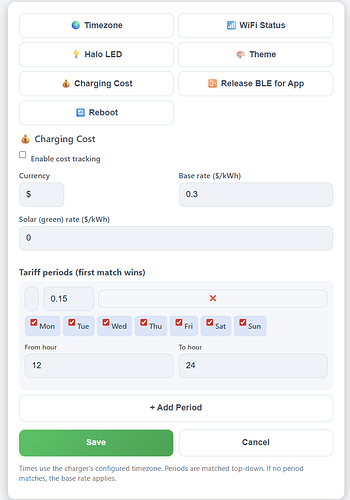

:money_bag: Cost tracking with time-of-use tariffs — set your $/kWh + custom
peak / off-peak / shoulder periods (any number of tiers, day-of-week + hour
ranges). See $ per session, per day, and Week/Month totals at a glance.
CSV export for spreadsheet nerds.

Set your feed-in tariff in the cost panel and you can also see what you
chose to self-consume vs export. Pairs with HA's Energy dashboard for the
long-term picture.
