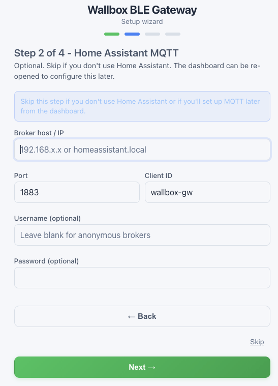

Question: This screen of the setup is only if you are using MQTT in HA, right? If I am using the integration, I can leave this blank?
@_Mike — your log nailed it, thank you. It wasn't the username or the host at all (your log shows the integration reached the gateway fine) — the coordinator was crashing on an empty status cache:
AttributeError: 'NoneType' object has no attribute 'get' (coordinator.py)
Your gateway returns {"status": null, …} (the same marginal-BLE thing as your blank dashboard boxes), and the coordinator didn't guard against null, so it crashed and took every entity down — which reads exactly like "won't connect." Fixed in integration v0.18.2 (release (Release v0.18.2 — fix coordinator crash on empty status cache · botts7/hass-wallbox-gateway · GitHub)) — update in HACS and it should come straight up. Pair it with firmware v3.2.0-beta.9 (adds a poll retry so the cache is less likely to be empty).
Your question — yes, correct: that MQTT screen is only for the MQTT-discovery path, which is an alternative to the integration. Using the integration (it polls over HTTP), you can leave the gateway's MQTT settings blank — no broker needed.

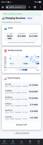

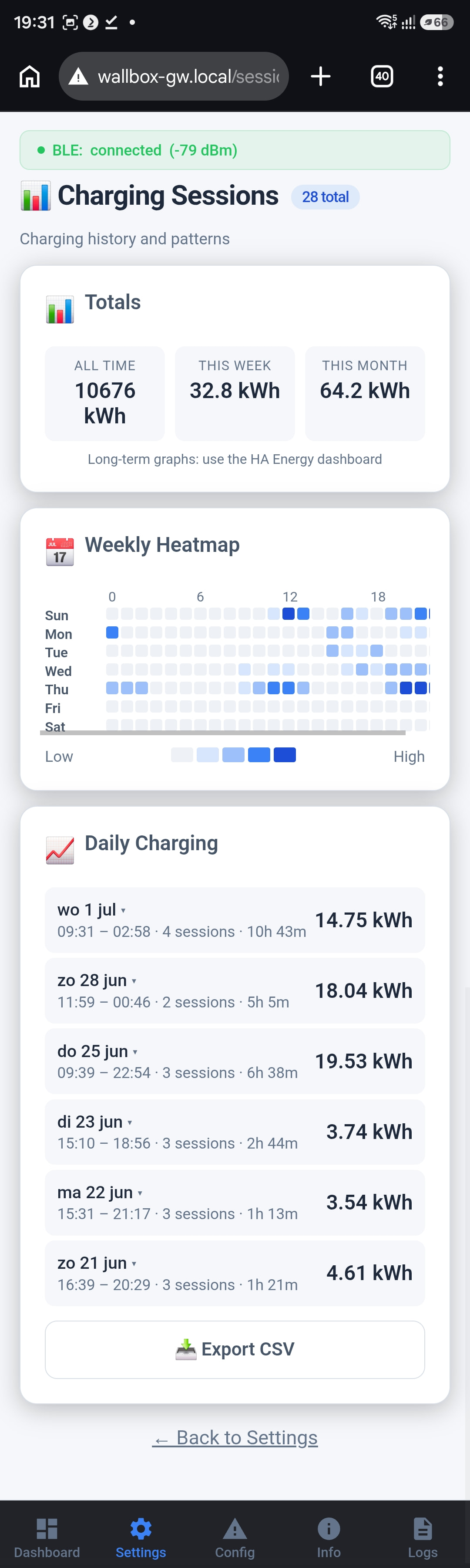

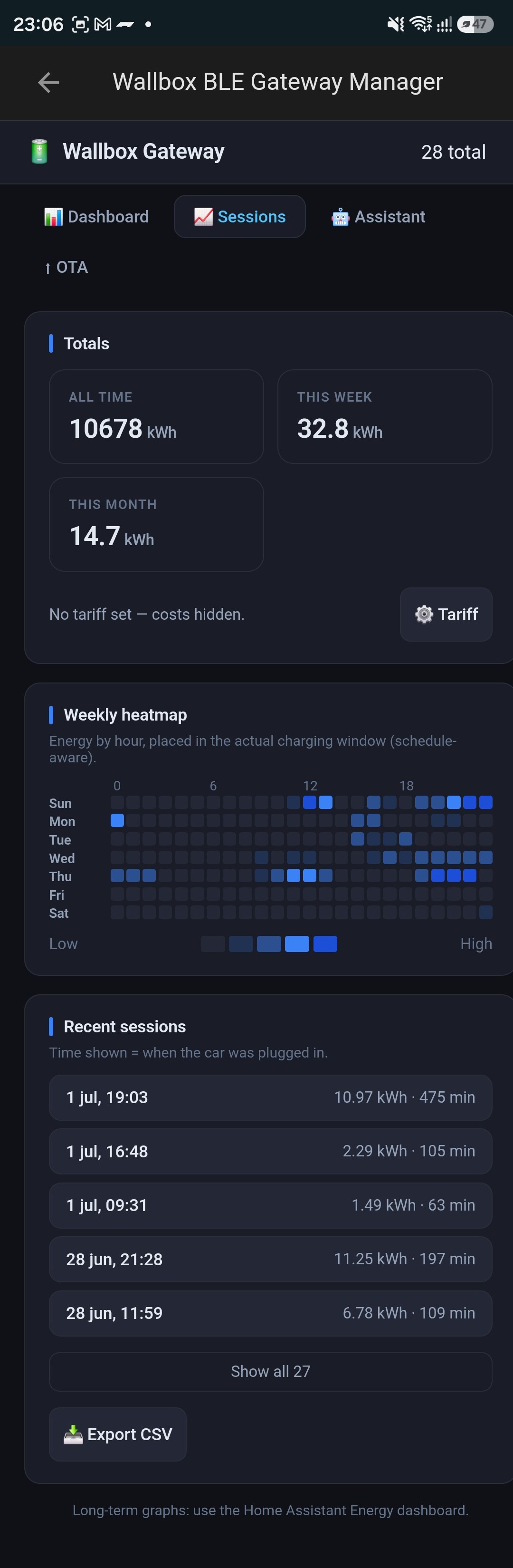

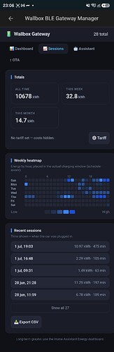

Still issues with the sessions. I removed the addon and reinstalled it, but to no avail. Below the screenshots of the current status. First image is from the addon. Second image from the gateway through (android chrome) browser.
Nailed it — thanks for the two screenshots, they pinpointed it. The totals were right but every session showed 0.00 kWh with an empty heatmap. Cause: the add-on read per-session energy from the charger's r_log, which returns 0 energy on some firmwares (I reproduced it on my own unit). Your gateway's charge-log does have the real energy — that's why the totals were correct.
Fixed in Add-on v0.43.0: the session list, heatmap and CSV now use the same charge-log ground-truth the totals use. Update the add-on (0.43.0), open Sessions, and the kWh + heatmap should populate. No gateway/firmware update needed for this one. Let me know how it looks!

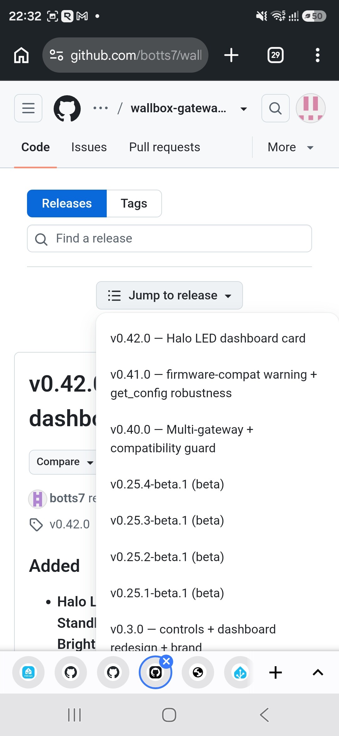

Cool! Where did you put 0.43? :grin:
It's pushed to the add-on repo now (v0.43.0). Home Assistant caches the add-on store, so you need to nudge it to pick up the new version:
  1. Settings → Add-ons → Add-on Store
  2. Top-right ⋮ menu → Check for updates (or just reload the page)
  3. Open the Wallbox BLE Gateway Manager add-on — it should now offer Update to 0.43.0
  4. Click Update, then reload the Sessions page
If it still shows 0.42.0 after "Check for updates", give it a minute (HA polls GitHub on a delay) and refresh again. No need to remove/reinstall this time — it's an in-place update. Your kWh + heatmap should populate once you're on 0.43.0.

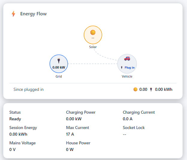

Hi. Updated to latest all round. I have two WB Pulsar Plus chargers. Both have this issue:
Max Charge current is populated in the dashboard:
But not in the integration:
Thanks for flagging this, @andypnz - two things were keeping it hidden: the sensor was disabled by default, and even enabled it only read r_sta.max_charging_current, which the Plus doesn't report (the dashboard uses r_dat.cur). Fixed in v0.22.1: enabled by default + falls back to r_dat.cur. Update via HACS → restart HA and it should populate.
Updated to 22.1... unfortunately the issue persists...
Ah, I know why — thanks for testing. This is a Home Assistant quirk rather than the fix itself: v0.22.1 made the sensor enabled by default, but HA only applies that to newly created entities. An entity already registered as disabled under the earlier version stays disabled after an update — HA never retroactively re-enables it. So your chargers' "Max charging current" sensors are still sitting disabled from before.
Enable it now (no need to wait): Settings → Devices & Services → Wallbox → your charger's device page → you'll see "+N entities not shown" → find Max charging current → open it → settings (gear) → toggle Enabled. Do it for both chargers; it should populate within a poll.
Or wait for the next update: I've added a one-time migration (v0.23.1) that auto-re-enables it on update — but only if it was disabled by the old default, so it won't touch anything you've deliberately turned off.
Once enabled, could you confirm it shows a value matching the gateway dashboard's "Max charge current"? That confirms the Plus fallback (r_dat.cur) reads right on your units — if it's enabled but blank, ping me and I'll grab the raw field.
