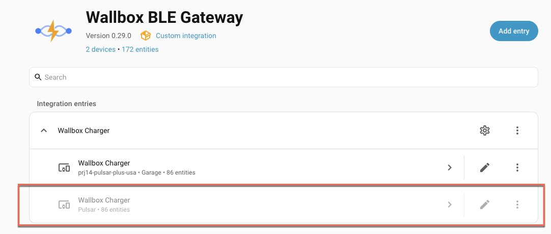

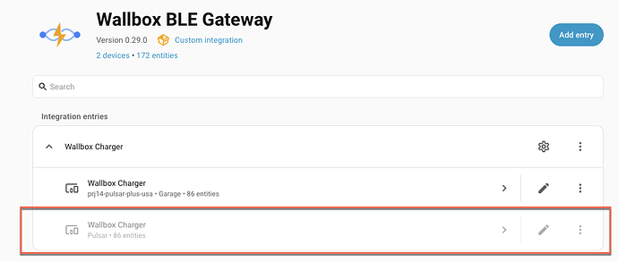

Hi @botts - Somehow I ended up with an orphan gateway instance. I am able to disable it, but there is no option to delete it. Any suggestions? Thanks!
Hi Mike — that orphan is a leftover HA device from before the integration had read your charger’s serial number (it briefly keyed the device off the config entry, then re-homed everything to a serial-keyed device once the serial came through). It’s harmless disabled, but the reason there’s no Delete is a gap on my side: the integration wasn’t telling HA it’s OK to remove its devices.
Fixed in v0.30.0 (just released). Update via HACS, then open the orphan device’s page and the ⋮ menu will have a Delete option — it’ll only let you remove the stale one, never your live gateway. :+1:
That did the trick! Thank you!!

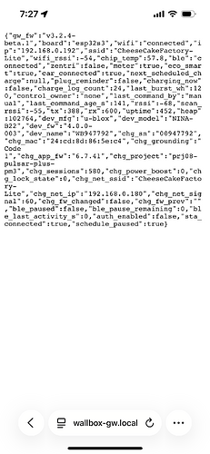

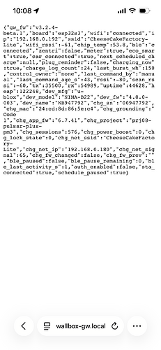

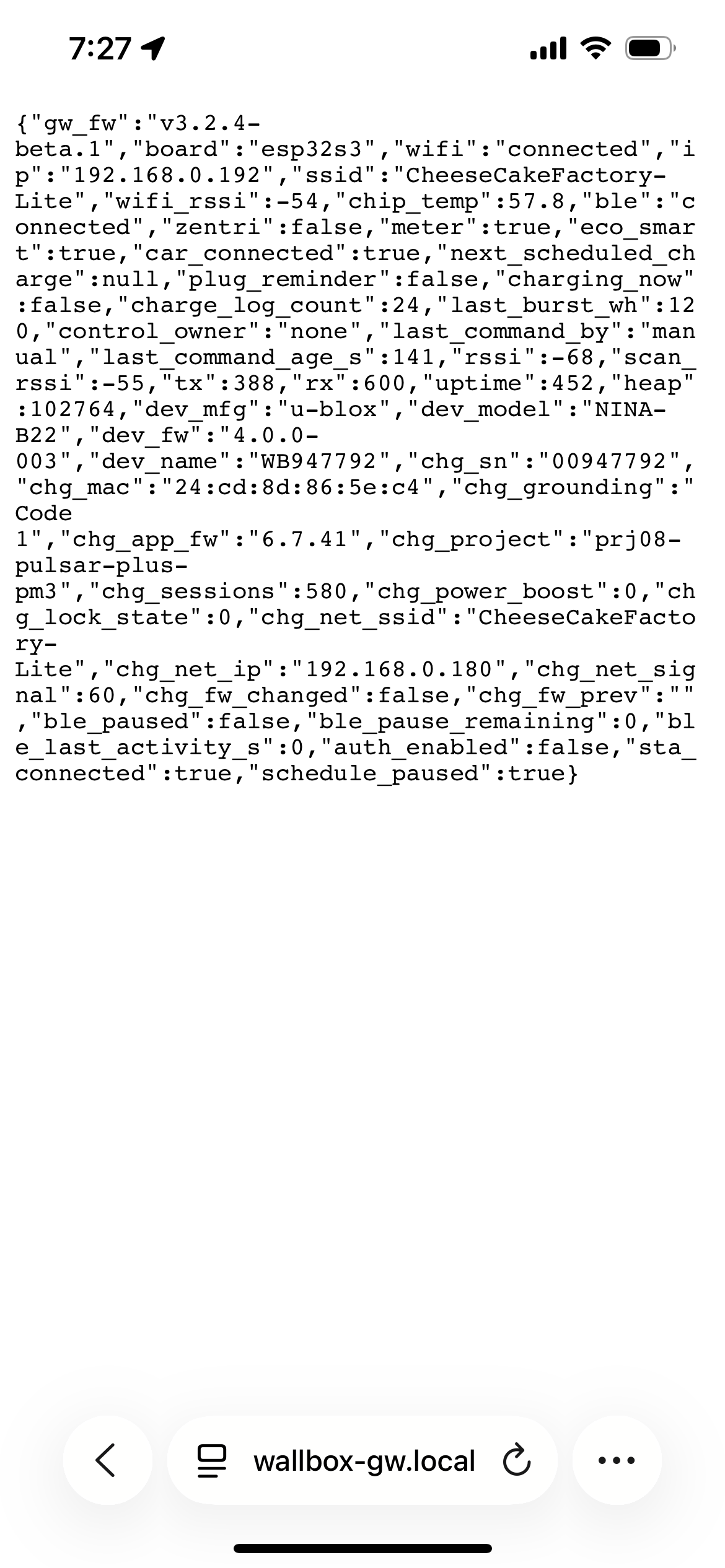

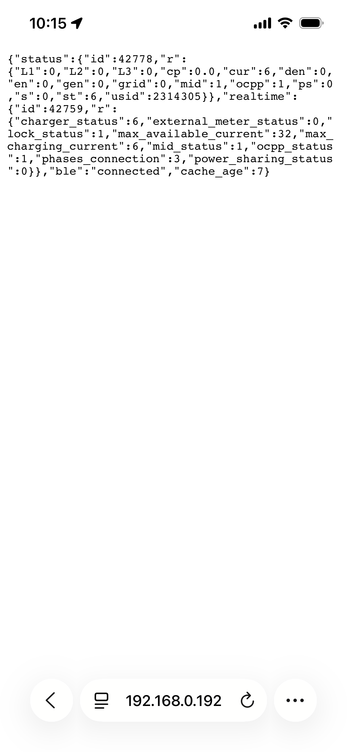

here’s the api/status:
Thanks Kenneth - your chg_project is pulsar-plus, so the beta is now sending the Plus stop parameter. But your status shows charging_now: false, which points at the real issue: the Stop is probably being skipped before the parameter is even sent, because the gateway isn’t recognising your charger’s “charging” state.

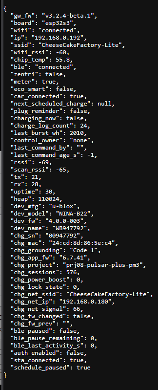

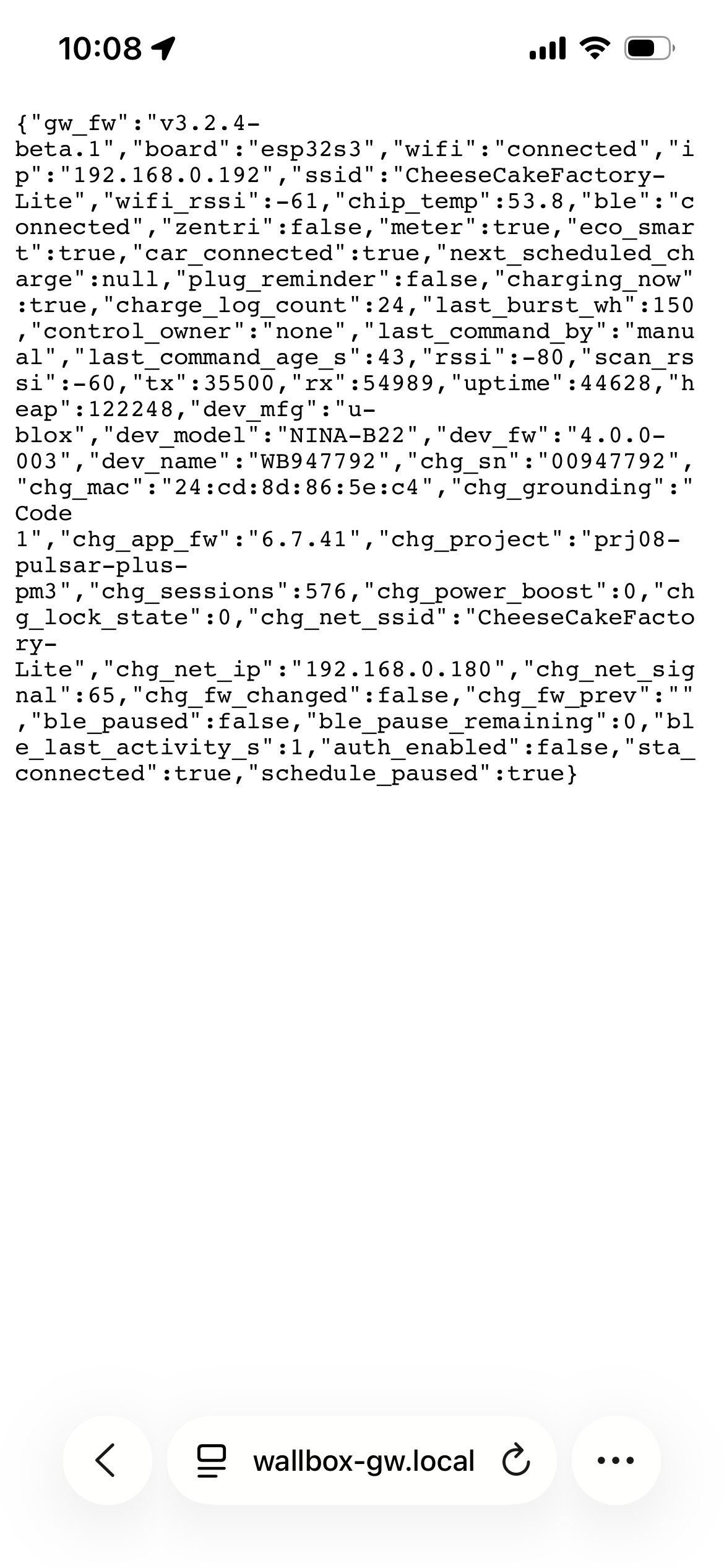

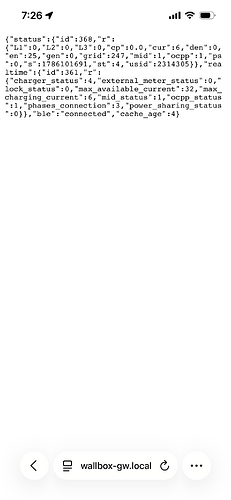

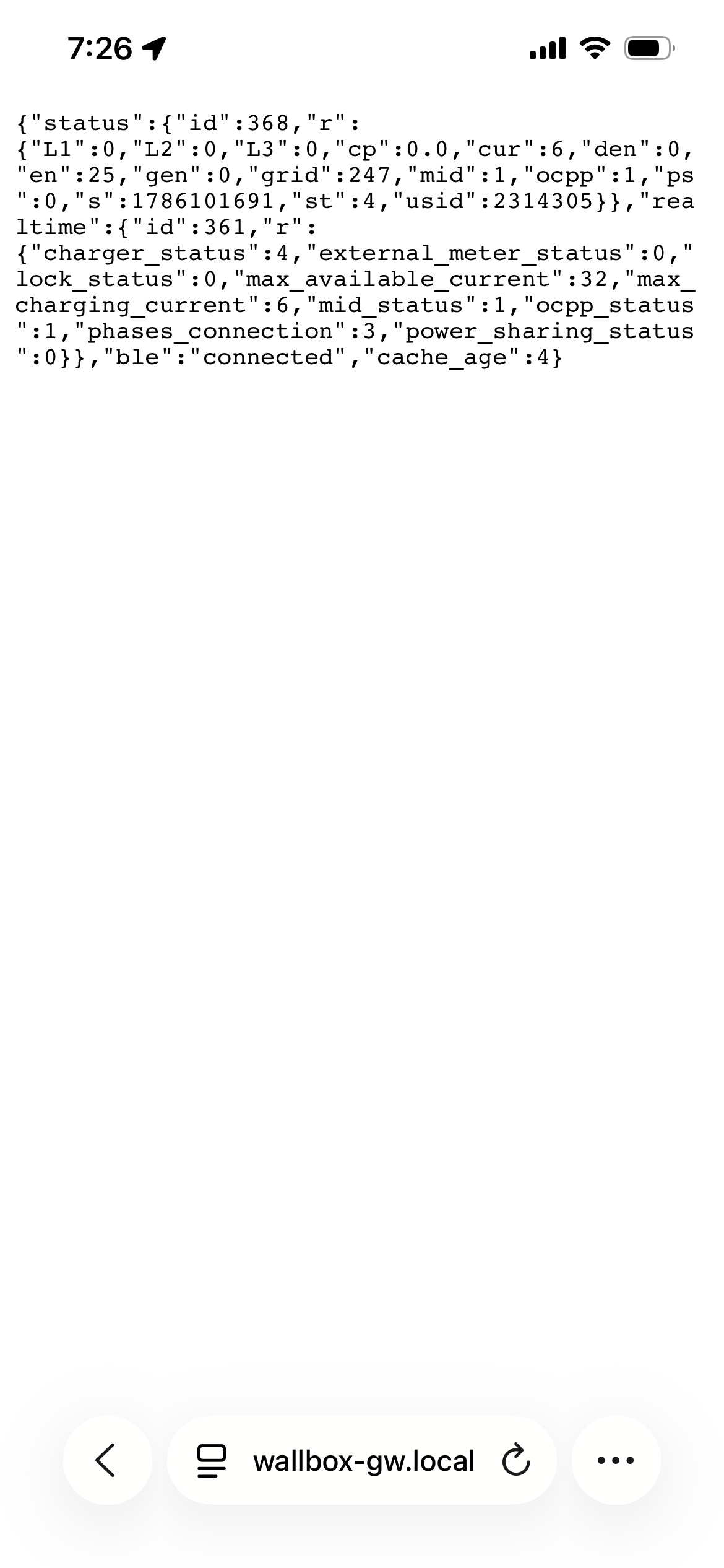

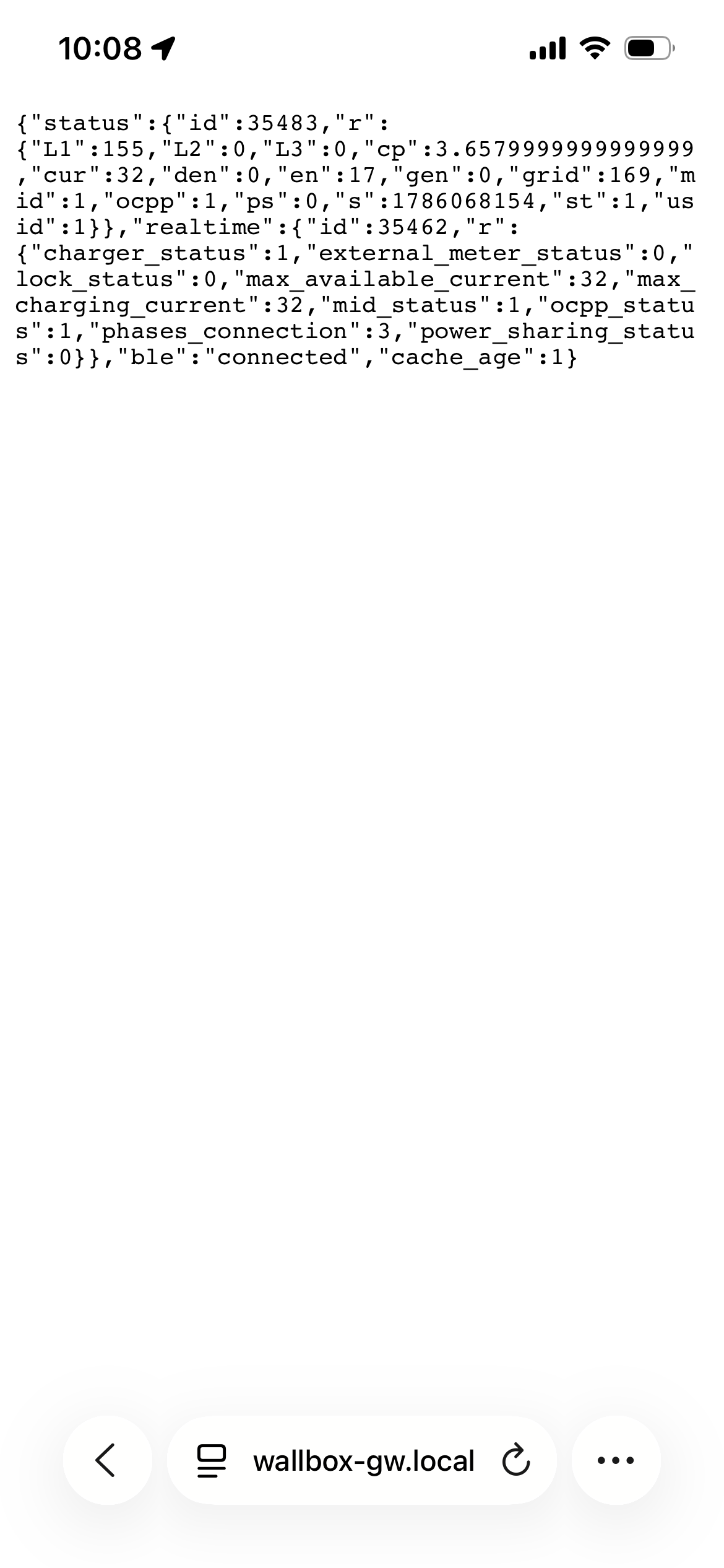

Ok, sorry - earlier i sent you the api/status when the charger wasn’t charging. I get a better idea how to use it now.
Here is the API status when the charger is charging:

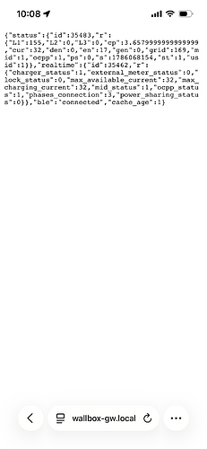

here is the output of api/charger while charging:
strangely unlock and lock now seems to work however i noticed that chg_lock_state is always 0, even when the wallbox is locked. i confirmed via wallbox app and status ring color.
Perfect, this nails it down. Good news: the gateway correctly sees you charging (st=1), so Stop isn’t being skipped, and it is sending the Plus stop parameter (par=0). The problem is your PM3 ignores it - and it ignored par=2 before too. So your charger needs a stop command neither the Plus nor Max convention sends, and I need your help to find which one works.

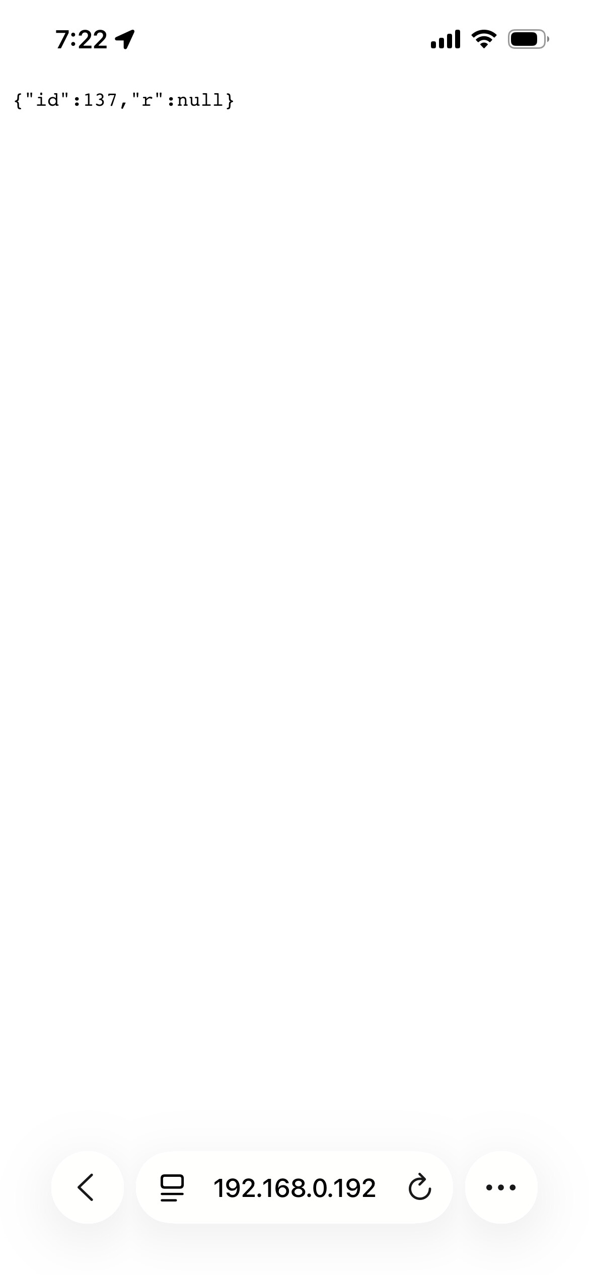

Hello @botts

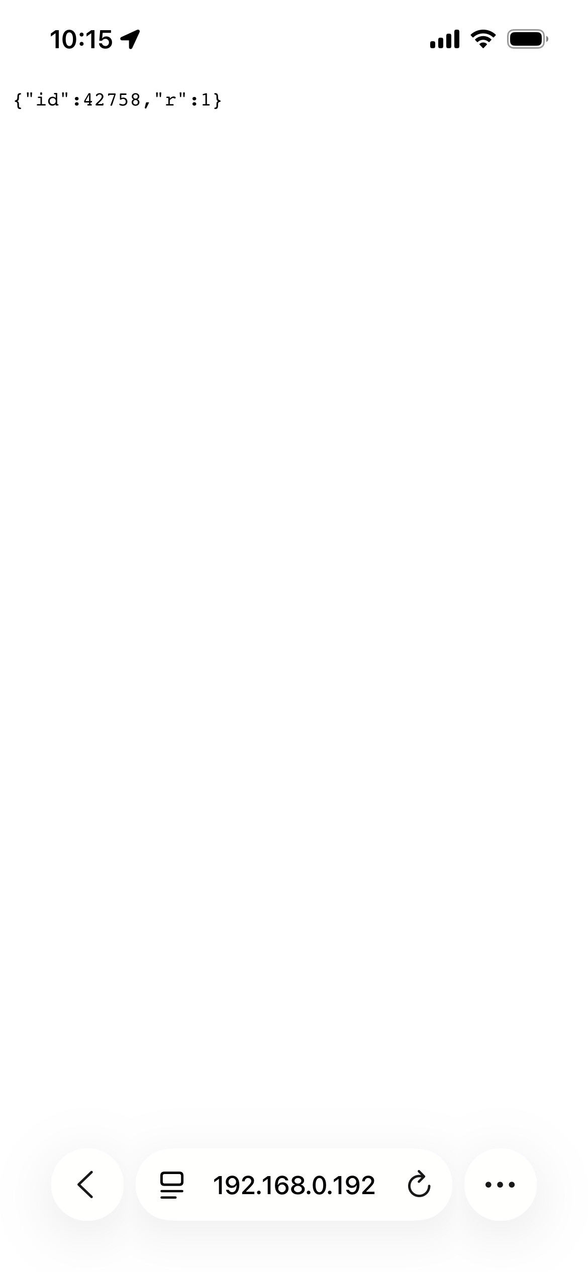

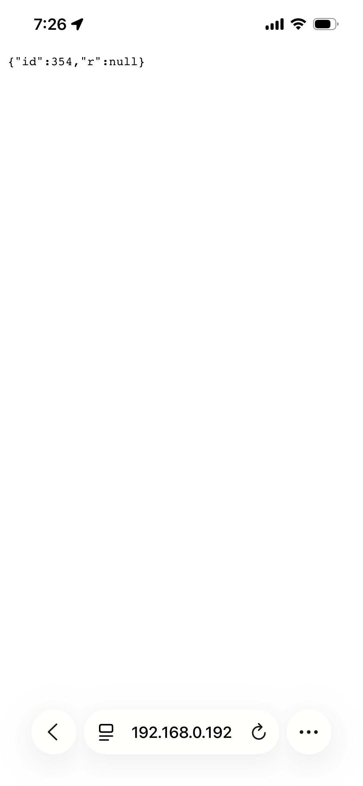

The par=2 command worked. Charging stopped (and didn’t restart itself, I waited about 2 mins).
The output from the command:
The other 2 commands didn’t work. The here are the JSON result after running the commands:

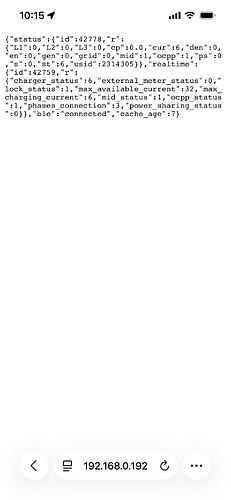

Here are the readings when locked:
Two fixes, both straight from your data — thanks, genuinely great debugging on your end:
  1. Stop - reverted my bad guess. Your PM3 needs par=2 (the “Max” value), which the gateway sends when it detects your charger as Max (single-char BLE stack). The Stop button will now do what the raw par=2 command did.
  2. Lock display - your charger does report lock correctly; the gateway was only reading it once at connect, so the entity froze. It now refreshes every poll and tracks lock/unlock live.
