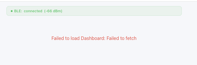

@botts I removed the other ESP for a good hour or 2, but it continued to fail at regular intervals.
Then I waited until a 15-minute increment and started refreshing the gateway page. This popped up at the same time that the integration failed -
So are you thinking it is a wifi issue? And if so, you mean wifi on the gateway ESP rather than in general, correct?
Two things it rules out immediately: your BLE is healthy (connected, -66 dBm, a good signal), so this isn’t a BLE drop, and the page itself loaded (the live BLE header rendered), so WiFi isn’t down either. What actually failed is one specific thing: an HTTP data fetch from the gateway (“Failed to fetch”), while BLE and the live status header kept working.
So to answer your question: it’s not WiFi, and it’s not BLE. It’s the gateway’s own HTTP endpoint briefly not responding, every 15 minutes. And because the Home Assistant integration polls the gateway over that same HTTP, that’s why the integration goes unavailable at the exact same moment.

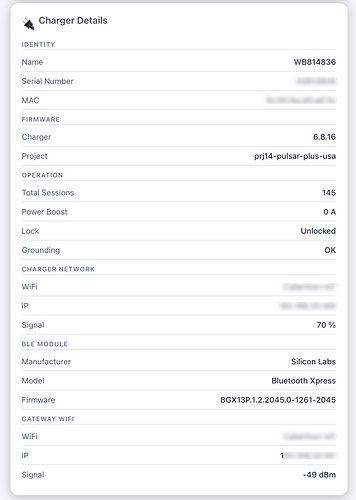

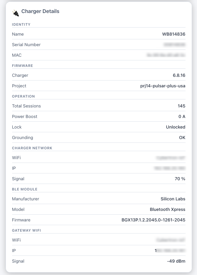

Is this what you are looking for?

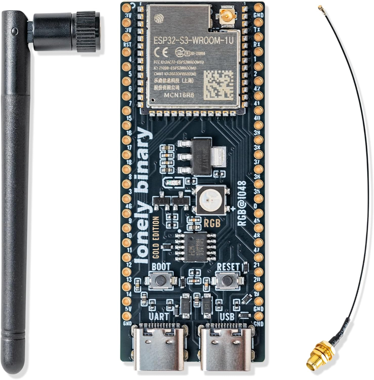

Welp. I bought this and it was delivered this morning -
Lonely Binary ESP32-S3 N16R8 16MB Gold Edition Dev Board + IPEX Antenna
I got it all set up and turned it on, and guess what - It also drops every 15 minutes. And this is while it was in a completely different place in the garage, far from the other ESP board. So something else is going on here. I’ll probably keep it anyway, since I have already 3D printed a case for it. And it is rated for higher temperatures than the previous S3.

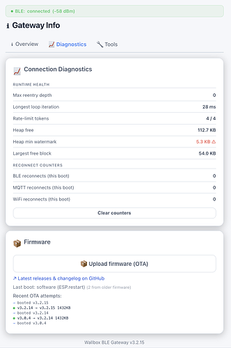

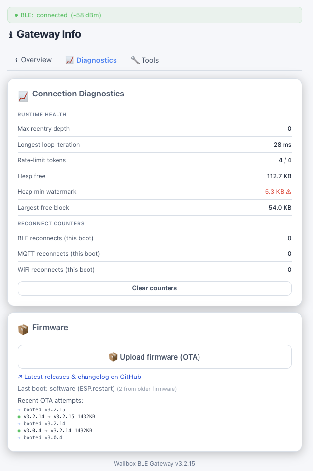

  1. Gateway /info page → the “Longest loop iteration” value. If it’s up in the seconds (not ~100 ms), the gateway’s main loop is stalling and starving the status read (a gateway-side bug I can fix). If it stays low, the loop is fine and it’s the network path.
  2. In HA, add custom_components.wallbox_gateway: debug to your logger, and when it drops grab the coordinator log line — it names the endpoint that failed (status / charger / charge_log) and the time. If two drops are 15 min apart, note both timestamps.
Also, which gateway firmware are you on now (/api/status → gw_fw)?
Between the loop-iteration number and which endpoint fails, I can point straight at the cause instead of guessing.
Hi @botts -
Thanks again for your help. I am on firmware v3.2.15.
Here is a screen shot from my info page -

Found it, and it is neither your network nor the board. Your /info screenshot was the key: loop iteration 28 ms (healthy), zero WiFi, BLE and MQTT reconnects (nothing actually dropped), but Heap min watermark in red at 5.3 KB. The gateway was running out of internal memory.
Home Assistant polls several endpoints at once every 10 seconds. The old firmware built and copied each of those responses in memory at the same time, and the charge-log one was large on a gateway that has been up a long time (the log had grown to its full size). That burst briefly exhausted the small internal-memory pool, so the status request could not be served and timed out after 4 seconds, and every entity went unavailable for that cycle. That is why it looked like a network blip when nothing had disconnected. Your box is affected and most are not precisely because it is so stable (long uptime, full charge-log), which is what makes the burst big.
The 8 MB PSRAM does not help this. The memory that runs out is the small internal pool WiFi and HTTP use, not PSRAM. So it was a firmware bug, not your hardware.
I reproduced it on the bench with a full charge-log: the old firmware collapsed to about 6 KB free (essentially your 5.3 KB), and the new firmware holds about 26 KB and the status read never fails. Fixed in firmware v3.2.17 (responses now stream instead of being copied, the heavy endpoints briefly back off if memory is tight so the status read is never starved, and the charge-log is handled without duplicating it). Update the gateway (Settings, or the web installer) to v3.2.17. After a day, check /info; the Heap min watermark should stay well clear of the red and the flapping should be gone. If you can report the new heap-min figure that would confirm it. Thanks for the screenshot and the patience, that is what cracked it.
