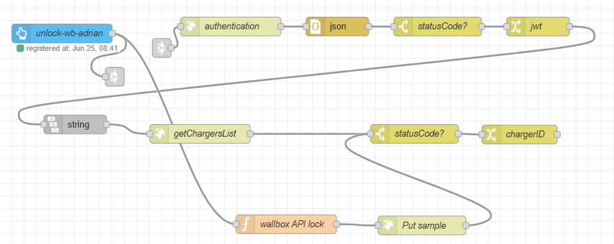

I ended up doing it with Node Red and making a button that would start the charging from different accounts. If you are still interested, let me know and I’ll find the resources I used and share what I have.

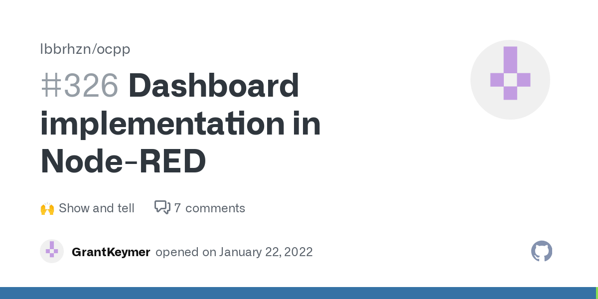

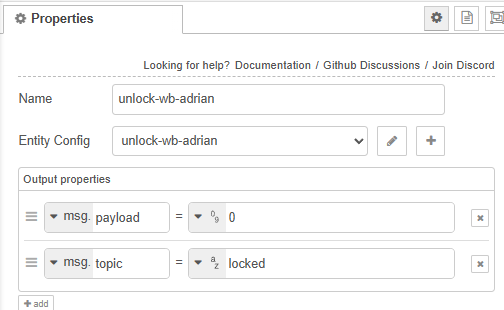

I used this thread and removed most of it to only leave the part left in the image. There’s a link in the thread to import the flow. Then I have another flow that is for the other user. The top piece is a Home Assistant button. I made one for each user. I use a Zigbee button that has a 1 and a 2 so if I push 1, it starts the charge session for one user, if I push 2, it starts the charge session for a different user.
I will say that I have to push it twice about 10-15 seconds apart. I think the first time it authenticates, then the next time it uses the authentication to be able to unlock.
I’m certain there are better ways to do this, but I was just happy I got it to work.
