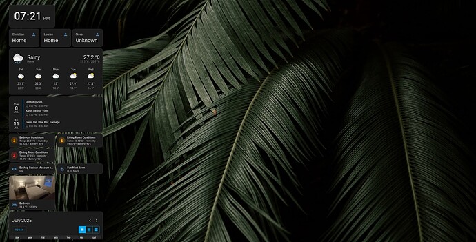

I’m not sure if I’m just missing something, but is there a way to prevent cards from stacking vertically in WallPanel for Home Assistant until they’re pushed off-screen?
I’ve tried referencing a view where the cards are arranged nicely, but when I edit the WallPanel config, it ends up squishing all my cards into a single vertical stack. When I try to add another vertical stack, it just nests it inside the existing one instead of placing it side by side.
I’ve attached a screenshot for reference — note all the empty space on the right side that isn’t being used:
