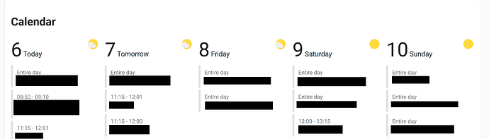

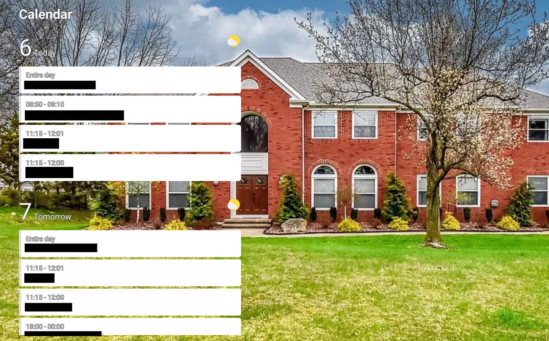

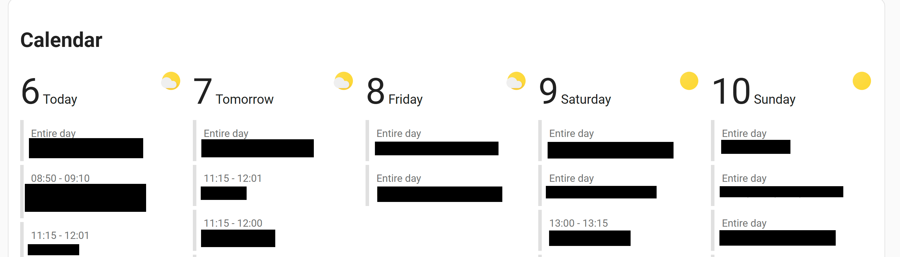

I’m looking for some help with this addon which has been stumping me for the past few days. I’ve put together a dashboard that displays my family calendar using a custom card: week-planner-card. I then add the Wallpanel info at the top and referenced my views within the wallPanel section of the YAML. When the screensaver starts the cards are not layed out like they are in the dashboard. Width wise i want the card to take up 3/4 of the display with the second card to take up the other 1/4 of the display.
Any help in width and styling would be great. thank you.
wallPanel shows only 1 column of days.
Dashboard shows 5 columns or more of days based on the display width.
YAML from raw configuration editor:
wallpanel:
  enabled: true
  fullscreen: false
  hide_toolbar: false
  hide_sidebar: false
  idle_time: 5
  image_url: media-source://media_source/local/slideshow/
  image_fit_landscape: cover
  content_interaction: true
  style:
    wallpanel-screensaver-info-box:
      '--wp-card-width': 900px
    wallpanel-screensaver-info-box-content:
      '--ha-card-background': none
      '--ha-card-box-shadow': none
      '--ha-card-border-width': 0px
      text-shadow: >-
        -0.5px -0.5px 0 rgb(17, 17, 17), 0.5px -0.5px 0 rgb(17, 17, 17), -0.5px
        0.5px 0 rgb(17, 17, 17), 0.5px 0.5px 0 rgb(17, 17, 17)
      '--primary-text-color': '#ffffff'
      '--secondary-text-color': '#dddddd'
  cards: []
  views:
    - title: Calendar
views:
  - type: sections
    max_columns: 4
    title: Calendar
    path: calendar
    icon: mdi:calendar
    sections:
      - type: grid
        cards:
          - type: custom:week-planner-card
            calendars:
              - entity: calendar.xxxx_xxxx_gmail_com
            days: '30'
            startingDay: today
            startingDayOffset: 0
            hideWeekend: false
            noCardBackground: false
            compact: false
            weather:
              showCondition: true
              showTemperature: false
              showLowTemperature: false
              useTwiceDaily: false
              entity: weather.home
            locale: en
            showLocation: false
            hidePastEvents: false
            hideDaysWithoutEvents: false
            hideTodayWithoutEvents: false
            combineSimilarEvents: false
            showLegend: false
            title: Calendar
            grid_options:
              columns: full
        column_span: 3
      - type: grid
        cards:
          - entities:
              - calendar.xxxxx_xxxxx_gmail_com
            weather:
              position: date
              date:
                show_conditions: true
                show_high_temp: true
                show_low_temp: false
                icon_size: 14px
                font_size: 12px
                color: var(--primary-text-color)
              event:
                show_temp: true
                icon_size: 14px
                font_size: 12px
            type: custom:calendar-card-pro
