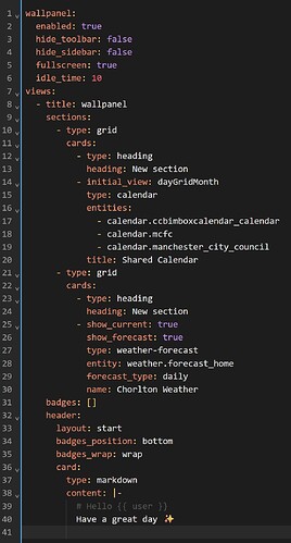

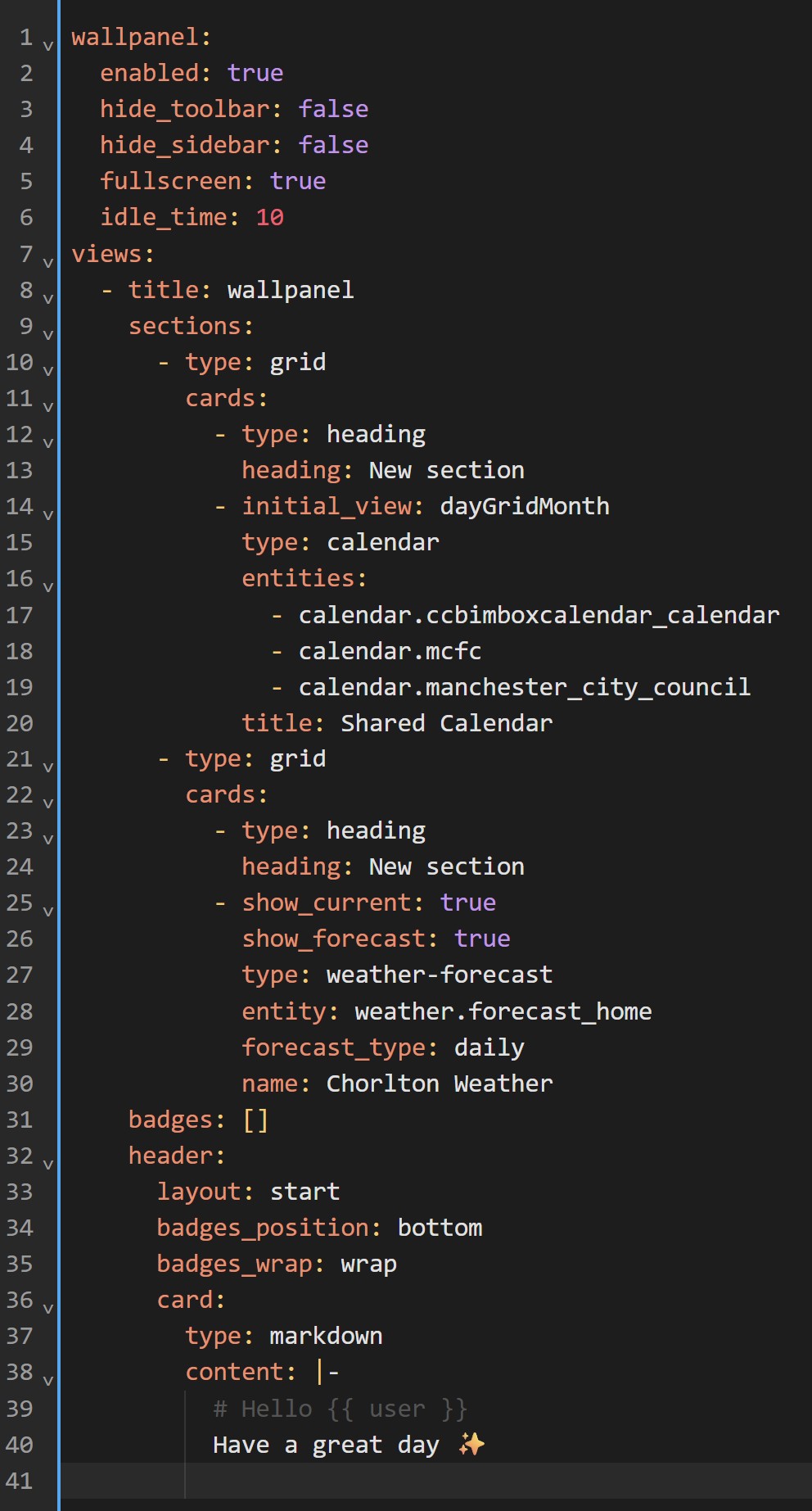

Hi - i’ve been dabbling with Home Assistant for a year in (very rare) spare time when not wrangling a toddler. I’ve finally got around to installing a Fire Tablet with fully kiosk installed in my kitchen and thought i would attempt to use wallpanel to display some basic cards - weather, calendar etc. All has installed fine and i’ve follwed the documentation but after the 10 second delay the dashboard switches to the screensaver image (i assume the standard unsplash pics) but no cards will show. I am now stuck. Is there some glaringly obvious thing i haven’t done?!? Any assistance greatly appreciated. Code here:
Sorted - didn’t have any cards in the code above views
