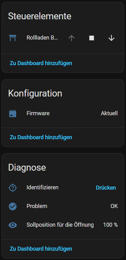

These are the provided entities:
So there is no power/energy measurement. The calibration happens to be done automatically on the fly, this works quite well.
