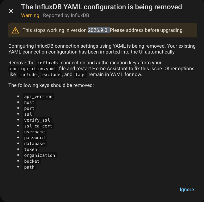

After latest update got following warning - anyone knows how to configure InfluxDB connection going forward with this changes in configuration.yaml ?
The InfluxDB YAML configuration is being removed
This stops working in version 2026.9.0. Please address before upgrading.
Configuring InfluxDB connection settings using YAML is being removed. Your existing YAML connection configuration has been imported into the UI automatically.
Remove the influxdb connection and authentication keys from your configuration.yaml file and restart Home Assistant to fix this issue. Other options like include, exclude, and tags remain in YAML for now.
The following keys should be removed:

Some of your influxdb config has been imported into the gui (Settings → Devices & Services → Influxdb).
Comment out the configuration options shown in the repair message. In your case:
Leave all other influxdb config as is.
Restart.

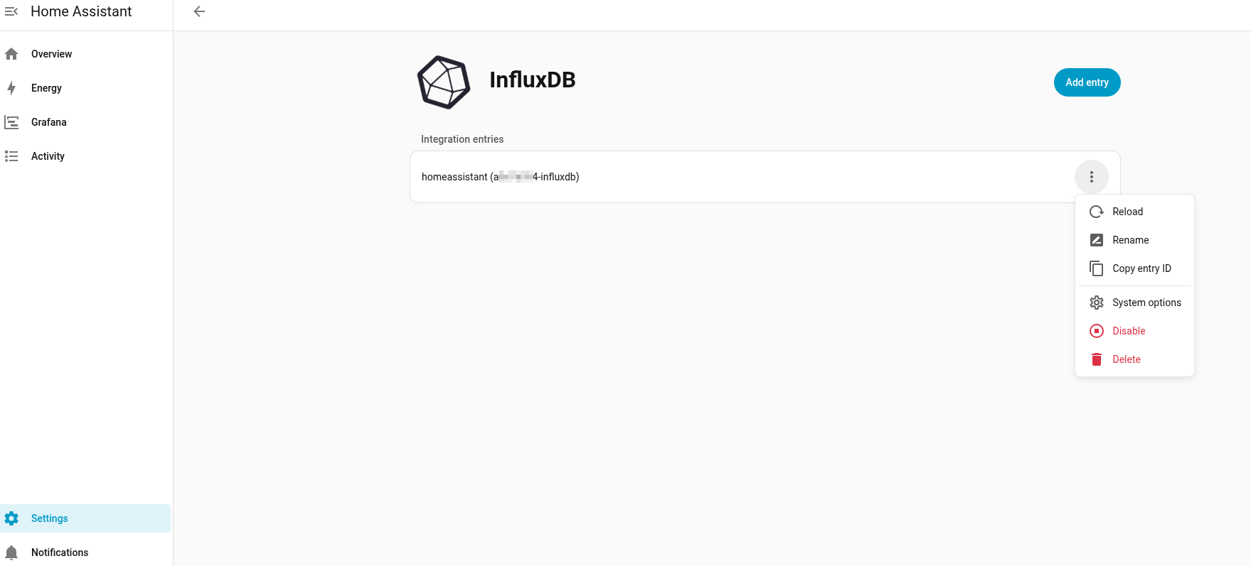

Yes, I have done this (host, username etc.) and the repair message disappeared after restart. I just wonder where I could view and edit those imported parameters in the GUI now? I would expect it in the three-dots-menu in the new InfluxDB-integration, but there is nothing, see screenshot. Pretty poor user experience. Or maybe in the InfluxDB-ā€œAppā€-Configuration? There is the port, but nothing else…

Where to see the values in the GUI? Before deleting something and push such message after an update, it should be clear where to find what.

+1 same problem as other’s have described above. After the auto-import I can no longer change the host - there’s no option in the UI. Very confusing.
