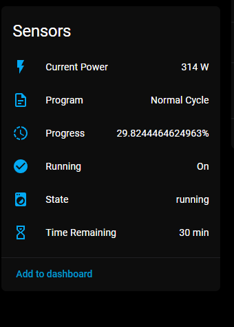

ok. Will do a few runs and save as profiles. Any way to fix the progress state readings? To many digits. Thanks for this integration.
Click the progress row to get the ā€˜More Info’ dialog, then tap on the cog wheel in the upper right, and set the ā€˜Display precision’ to your liking.
Thanks. Knew that settings, but forgot it.

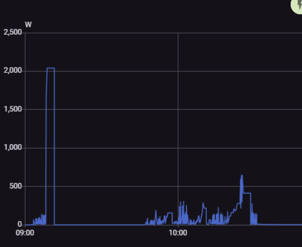

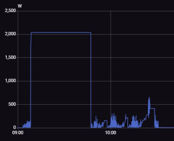

i just need help, this morning it doesn’t detect well my cycle. A special cycle with a long time warming the water.
Here’s what the smart plug saw:
and Washdata saw:
I think this is because the device remained at 2039w for a very long time without a new measurement point.
Any idea ?

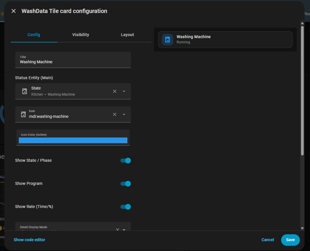

I’ve got this installed, and it’s linked to my washing machine no problem, and profiles are ingesting correctly etc., but I can’t get the ā€˜beautiful’ tile card to show up? It’s only showing me a regular tile card, though the additional options appear to be configuraable?
I’ve tried redownloading within hacs to see if it didn’t pull all the resources down properly, but it still only shows a regular tile.
I’m probably missing something super obvious, but I can’t figure it out if I am. Any tips?
beautiful card in not associated with me, its external development so I would aim your issues to developer of this card. Try hard refreshing frontend tho, that might help.
