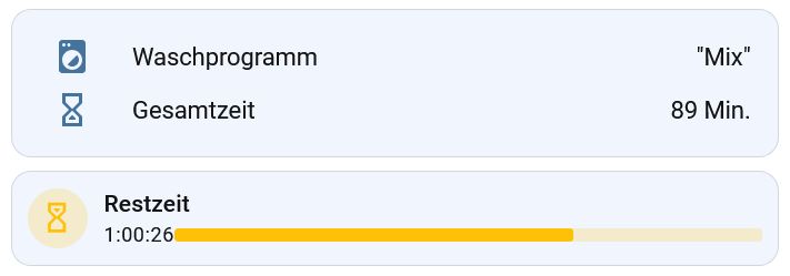

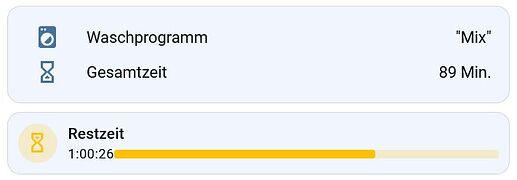

I only discovered this add-on today, and I have a few questions:
  1. Do I need to record each washing program five times for it to work reliably?
  2. Is it possible to display a progress bar on my Home Assistant dashboard that shows the current progress of the washing cycle, along with the estimated time remaining? If so, could someone please explain how to set it up?
    @3dg1luk43
  - type: custom:hui-element
    card_type: entities
    entities:
      - entity: sensor.lg_washing_machine_program
        icon: mdi:washing-machine
      - entity: sensor.lg_washing_machine_run_duration
        icon: mdi:timer-sand-complete
    card_mod:
      style: |
        ha-card {
          background: rgb(240, 245, 254);
          font-size: 104%;
          box-shadow: none;
          border: none;
        #states > * {
          margin: -8px 0px !important;
  - type: custom:timer-bar-card
    card_mod:
      style: |
        ha-card {
          font-size: 104%;
          box-shadow: none;
          border: none;
        #states > * {
    entity: sensor.lg_washing_machine_state
    active_state: running
    guess_mode: true
    invert: true
    bar_direction: ltr
    bar_width: 60%
    mushroom:
      layout: horizontal
      color: amber
    sensor:
      device_class: duration
      entity: sensor.lg_washing_machine_time_remaining
      unit_of_measurement: min

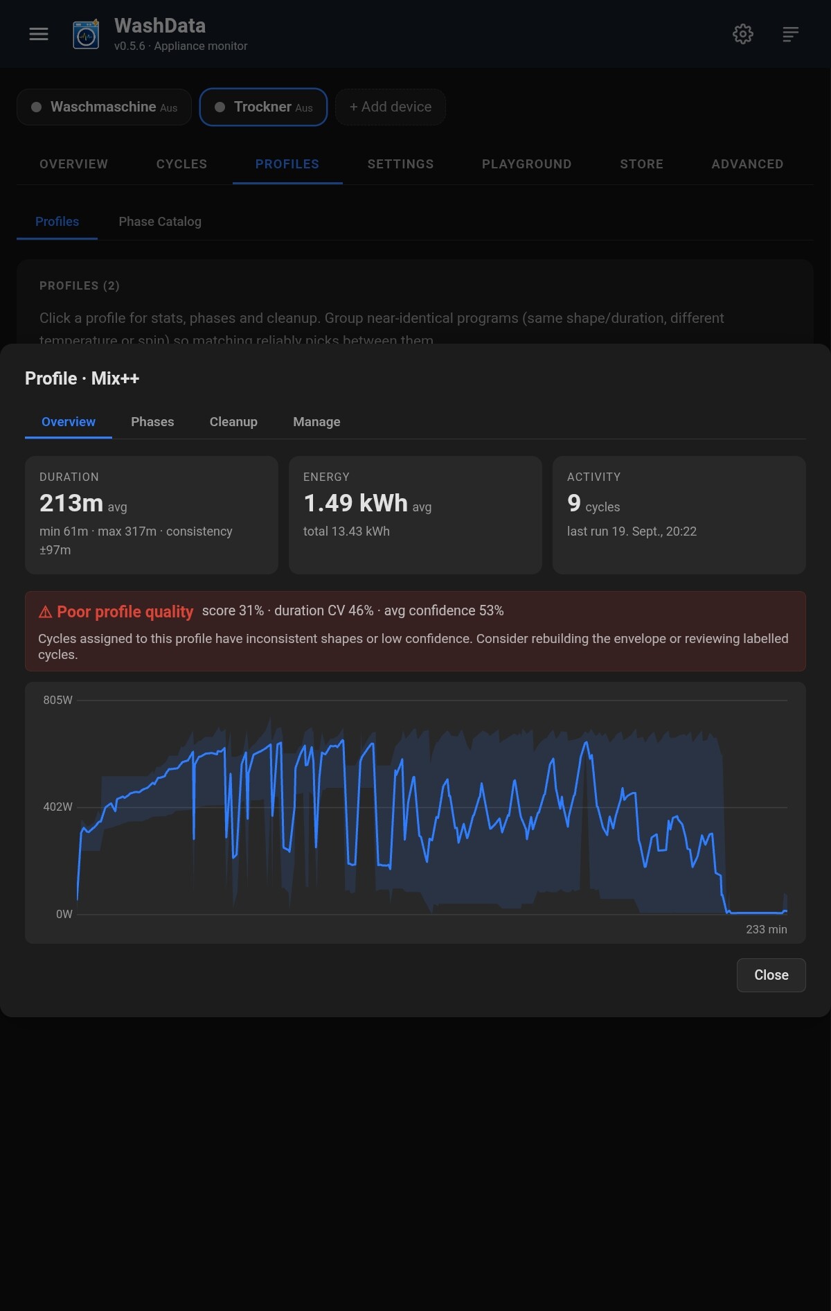

I have this integration up and running, 9 cycles for my dryer and 13 for my washing machine, but my dryer has a sensor so it doesn’t take the same time every cycle because it depends on load and moisture.
How can I let WashData still predict the remaining time?
The profile is labled as “poor quality” because the durations are so wildly different…
