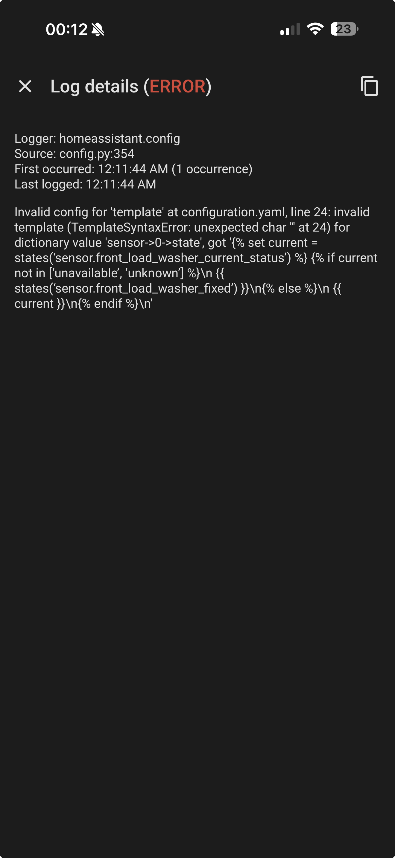

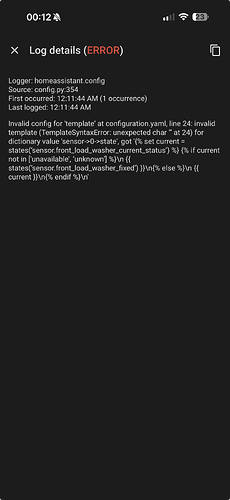

It shows this error straight away:
I didn’t catch it myself but you’re using the wrong type of quotes. I call them “fancy” quotes that are the type that some word processor software uses. you need the “plain” type of quotes that things like notepad uses.
it’s hard to show the difference but this should show it:
vs
with the first ones you can see the they are more curved.
the second ones are more straight.
that’s the danger in using stuff copied from other people. you should usually just try to re-type it yourself or fix the quotes if you get this type of error.

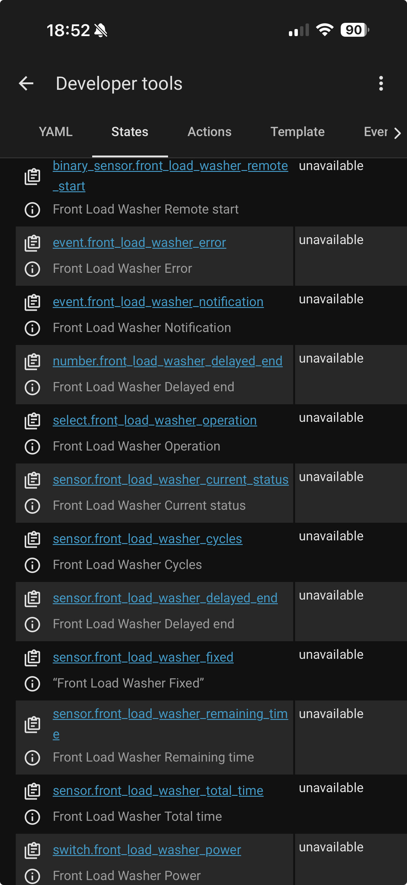

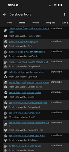

This is the screenshot of the entities when i reboot

I turned the Wash Machine on and the original entity goes to Power_Off and the fixed goes to unknown, once I reboot home assistant both go back to unavailable.

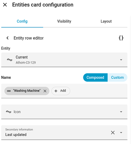

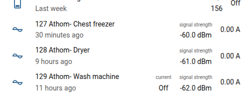

Note 1: I have found it useful to display the “Last Updated” as Secondary Information in an Entities card
